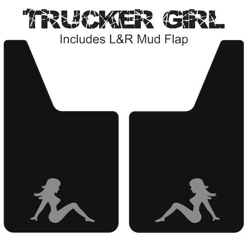

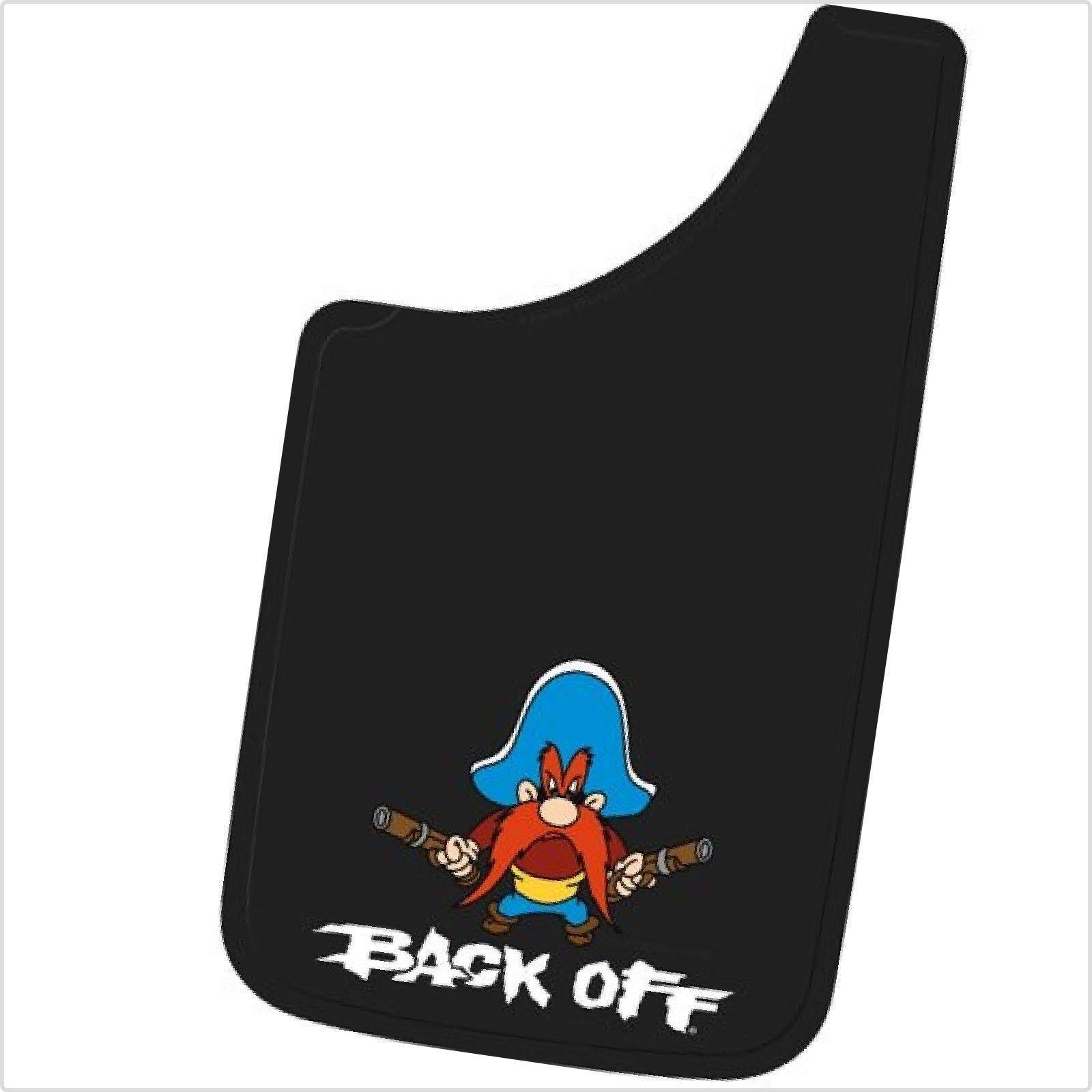

I can think of 2 acceptable flaps. But mostly no

Pirate. Do you have one of those hitch inserts with ***** hanging down or do you have a customer made hitch with ***** hanging down? That would definitely compliment the mud flaps.
