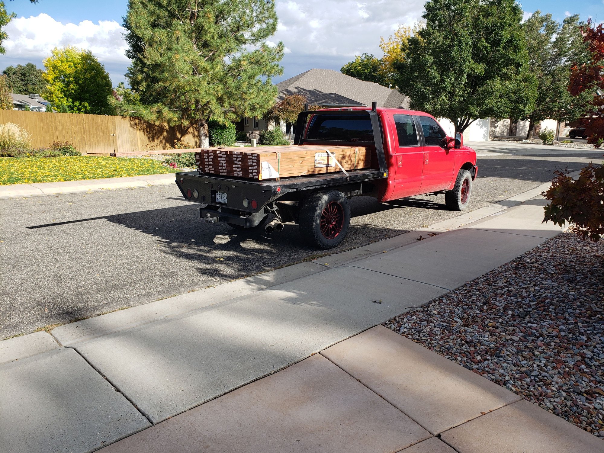

Its been a month. Ive been swamped. Between the fields, the house, building multiple fences, doing electrical at the house, building a covered porch, and just random stuff here and there I haven't had time to do anything productive on the truck. The poor truck only gets cranked up to move 3klbs or more on the bed. Not pictured is the 3600lbs of 40x 80lbs concrete bags.
