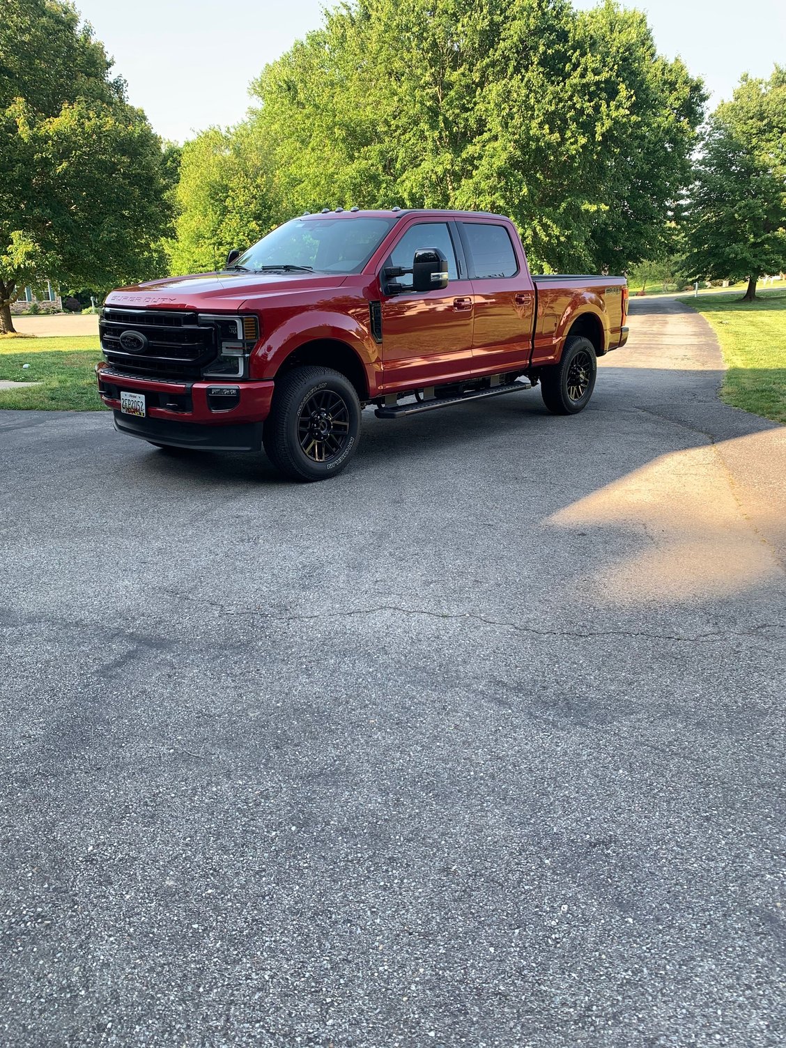

Pics of the truck this is going on.

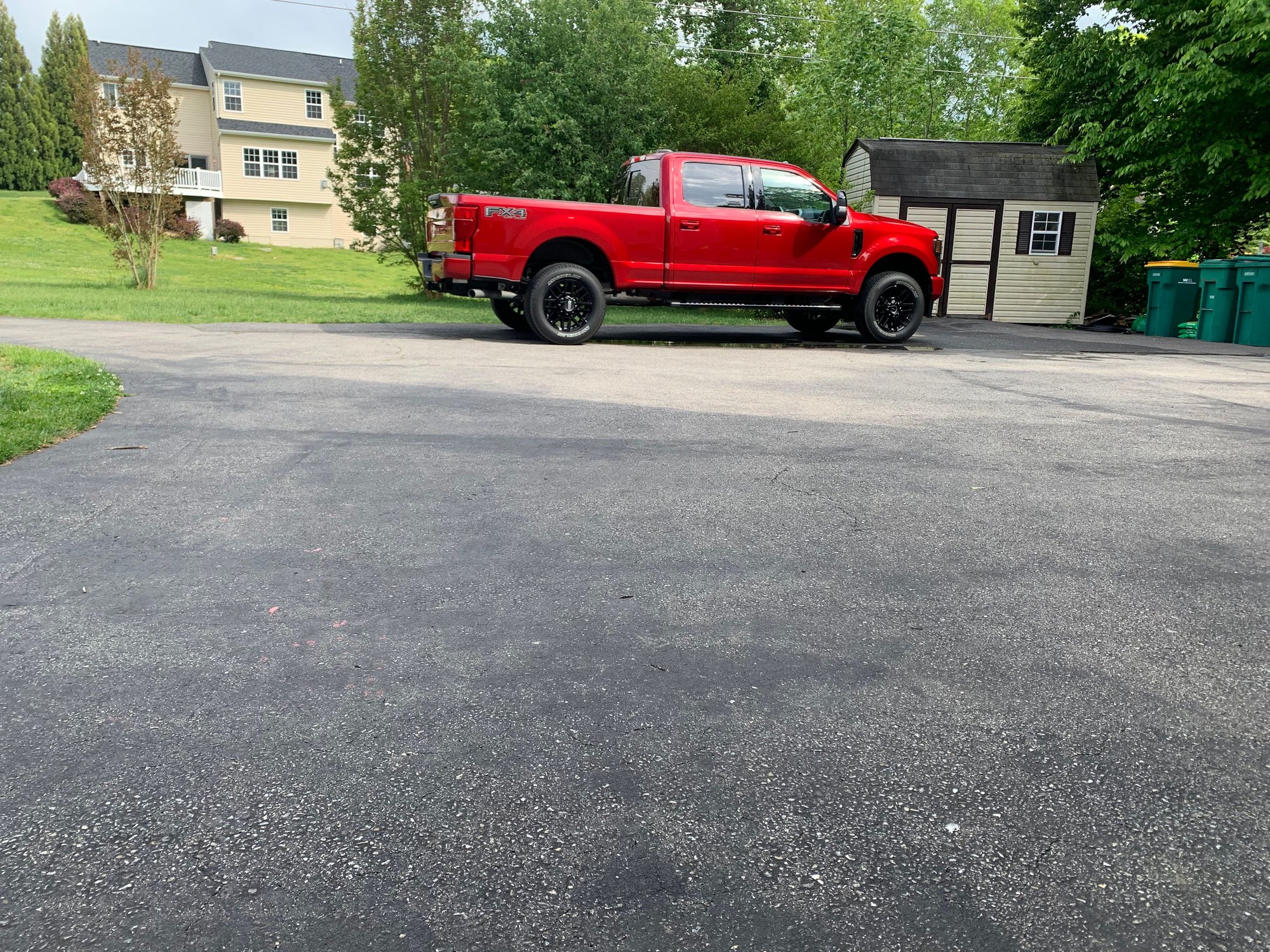

Your factory rear shocks should be fine. Here is mine with the readylift 2.5" sst kit, 4" rear block. 37s
factory rear shocks?
Nope, went Bilstein all around. I'm sure the factory rears would be plenty long though.
