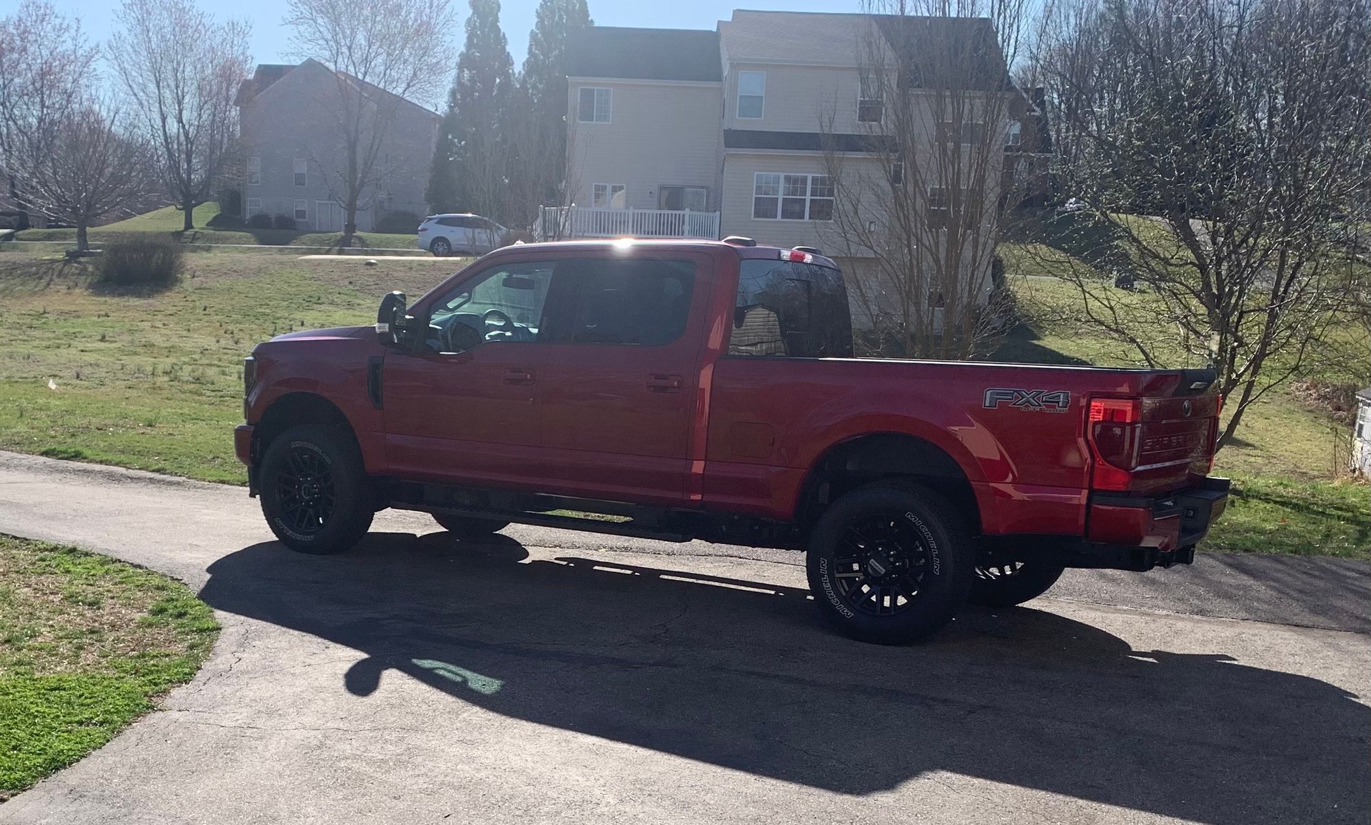

That kit will work, but it's front end only. You'll have to source your rear blocks somewhere else. What size tire are you wanting to run? If only 35's, I'd stick to a 1.5" front only level. If you want 37's, do the readylift 2.5 sst which comes with 2" taller rear blocks.
Here is my truck with the readylift and 37s.
looks nice but I don’t want to make the truck quite that high. I think 1.5-2 looks best with 35s (which I wanna limit myself to for performance reasons). I’ve had trucks with 6” lift kits and it’s not the best setup for me anymore. So while I wanna make it a little more aggressive looking I want to keep it tame at the same time.

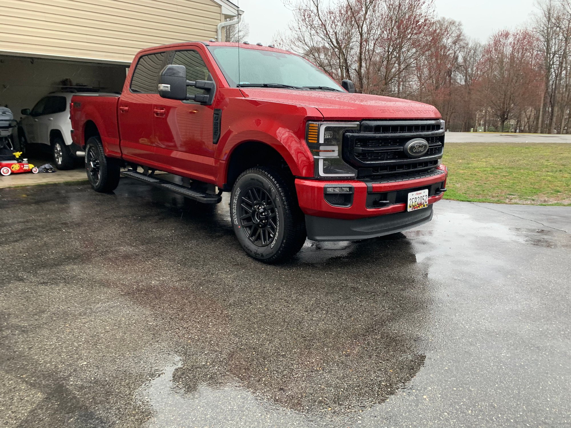

I went with Carli 2.5 with pin tops. 325/65/20 with stock rims.

any rubbing with stock wheels and 325s on that level
kit?
Old May 1, 2021 | 08:56 AM
j MCQ's Avatar
j MCQ
Joined: Mar 2021
Posts: 26
Just had it done yesterday, I hopped over the curb backing in a trailer a few times yesterday and was fine. Tire shop told me i could get some tire rub on a locked right turn, it didn't yesterday but will try it today.

Gotcha. The level and tire height both look good. Like I said I’ve had the “lifted” look and I’m done with it. Just want a tad more ride height and yours looks perfect.
Did they give you any crap for mounting 325s on an 8” wheel?
