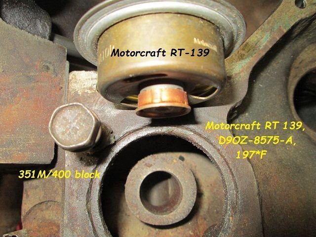

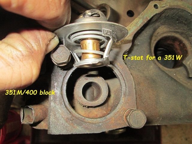

I know that some parts people will give you a wrong thermostat for a 351M or 400. These two engines have the bypass cast into the block, it's a passage way directly under the thermostat. It is open to free flow when the thermostat is shut, so coolant flows through it to bypass the radiator since the thermostat is shut still. As the engine warms the coolant, the thermostat starts to open so that coolant can go through the radiator, and as it opens a "hat" looking piece on the bottom of the thermostat "pill" is pushed downward towards the bypass, thus restricting it so that coolant is forced through the radiator.
351C used the same thermostat but it's also got a restrictor that gets pressed in place in the block to work with the "hat". I think it often comes with the ring but the ring will not work in a 351M or 400 block.
If a wrong thermostat, like say a 351w, etc ... is used, the bypass never gets restricted and coolant that is way hot simply gets to bypass the radiator and keeps circulating in the block and heads and the running engine just gets hotter and hotter even with a wide open thermostat. I kept a couple old RS-333-xxx thermostats just to keep the hat available if I ever need to press it on a regular RS-330-xxx thermostat. Those RS 333-192 were great. The Motorcraft RT139 works well too, looks a lot like the highflow Robert Shaw thermostats.
I have in my notes a note about the NAPA THM 197 and the THM 297 working, but I don't know how well they work.
