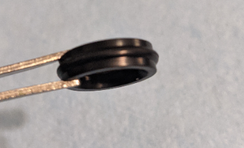

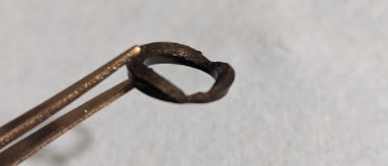

2005 no start hot FIXED
Hi all. Finally found the leak.
Injector #8 top o ring. Pics show good and bad.
These were Alliant o rings that I installed 5 years ago. I replaced all 8 then and just put new ones in during this fiasco.
Huge lesson learned, if you have to open it up, do everything; stand pipes, dummy plugs, nipple seals, nipples, injector o rings, IPR valve. May be costly, but consider it maintenance.
