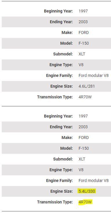

My 2003 5.4 currently has 103K & I figured it's since it's now my current daily driver (Was spare vehicle) it be a good time to drain the Transmission fluid. Fluid currently has about 40-50K shifts like butter but it's been put off long enough.
I'd assume that this truck used the 4r70W transmission & was wondering has anyone swapped the stock Transmission pan for one that has a built-in drain plug? Figured I can do fluid change ever 20K & do a filter change ever other time (40K)
https://www.summitracing.com/parts/r...-150/year/2003

For ~$30 the Dorman pan is one of the very few Dorman products that isn't crap. RA also sells a variant under the SKP name for sub-$16 that has the same part # as the Dorman, but shipping might kill the deal.
I've welded nuts into C6 pans before but for $30 or less my time is more valuable these days, plus you get a flashy new black paint job on the new pan.
The "why" for me is because balancing a cake pan full of wet batter overhead as you attempt to lower it and minimize spillage is just dumb....AND as others have stated you can now periodically drain your fluid and not disturb the pan. The internal filter has a lot of surface area and shouldn't need to be changed often -- perhaps only once in the lifetime of the vehicle.

I was just asking because if the Domain Model does fit I'd rather swap to this pan since I'm already due for the fluid/filter change & make the fluid change much cleaner & easier in the future.

I've put the Dorman model on an '03 4R70, '07 4R70 and '08 4R75. I like it personally (shrug). I got all of them thru AWD (Amazon Warehouse Deals) and they were all in great shape. I don't see any in AWD but presently $24.45 new, shipped, although if enough people click this link the Amazon bot may jack the price:
