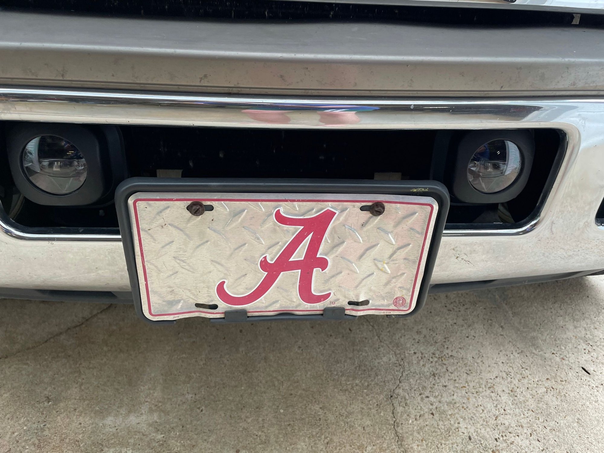

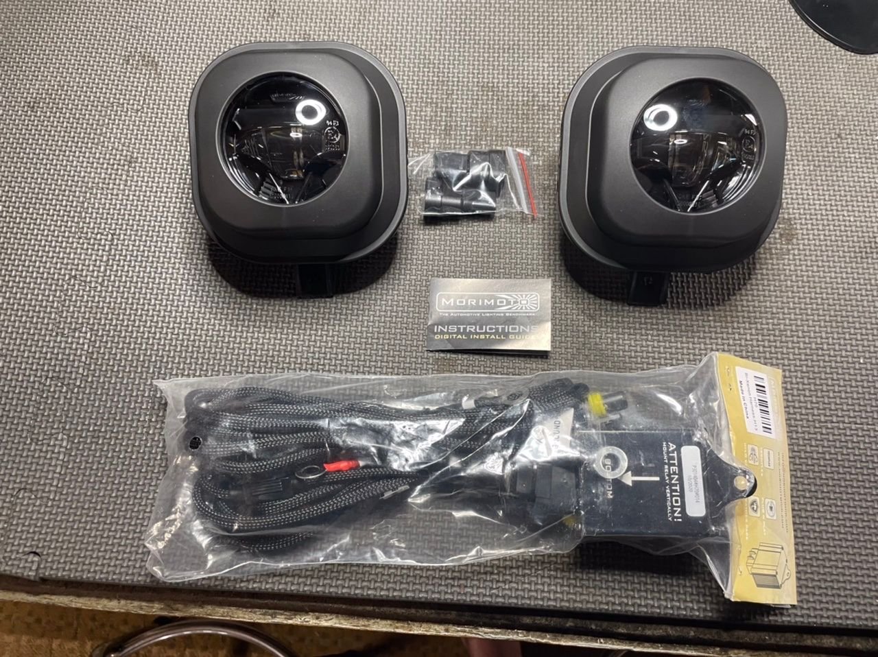

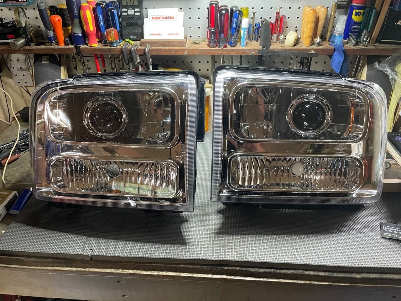

Well, I got my lights in today. No hassles or timing problems and it looks like a good job on the retrofit. I plan to put them in this weekend.
I went ahead and got the fogs to go with em.
Any tips, tricks, or “heads ups” appreciated. It looks pretty straight forward but ya never know.

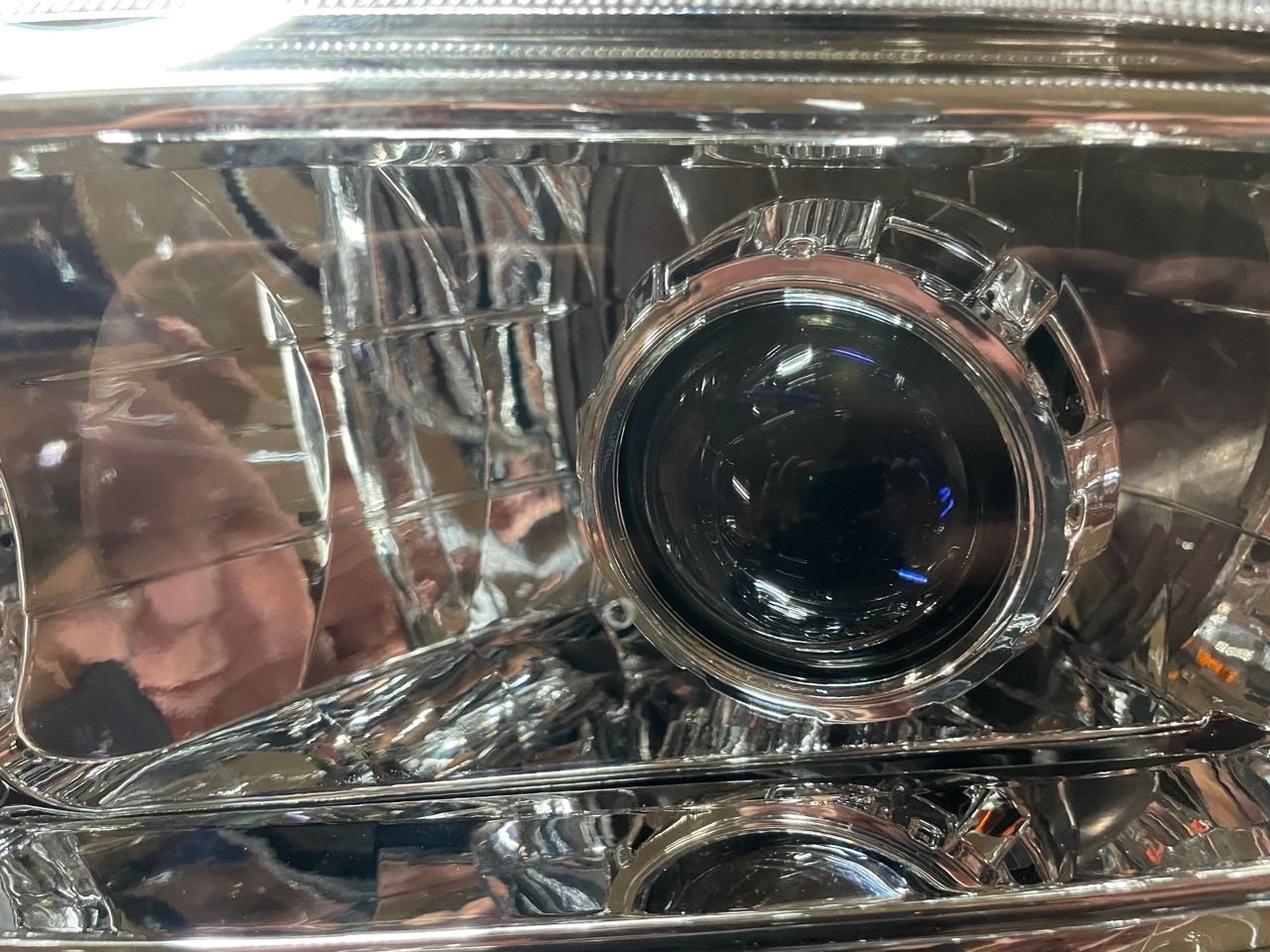

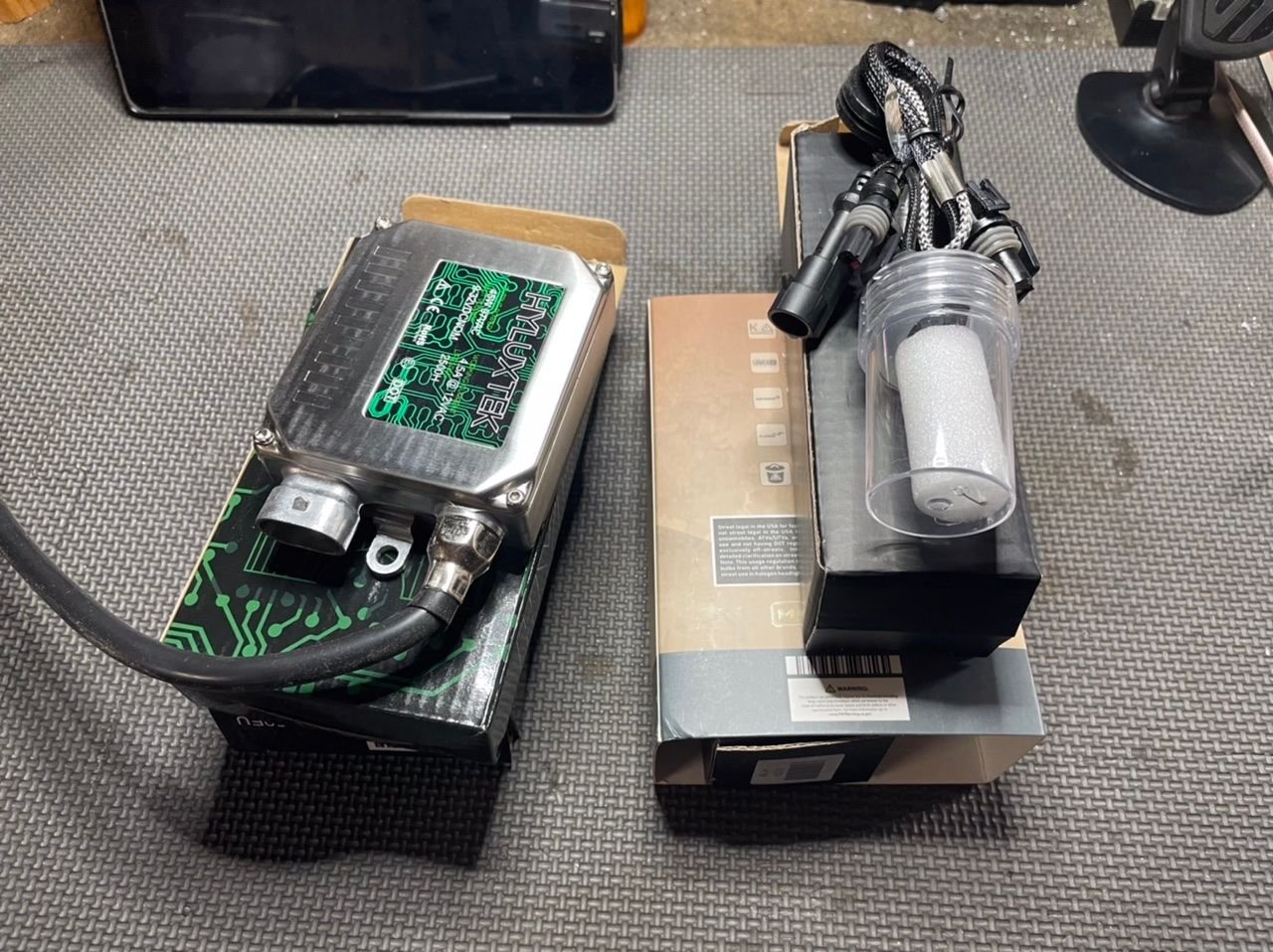

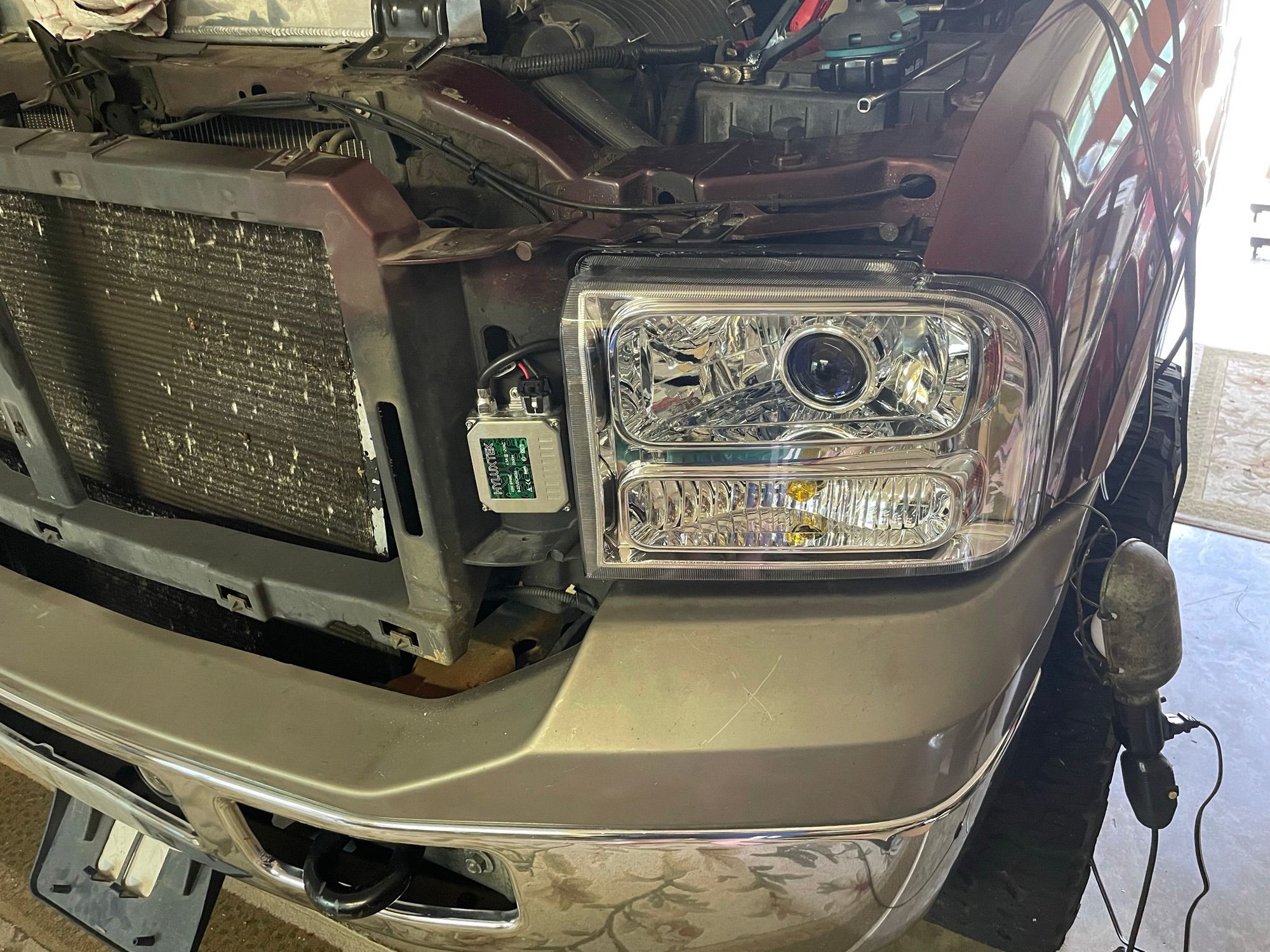

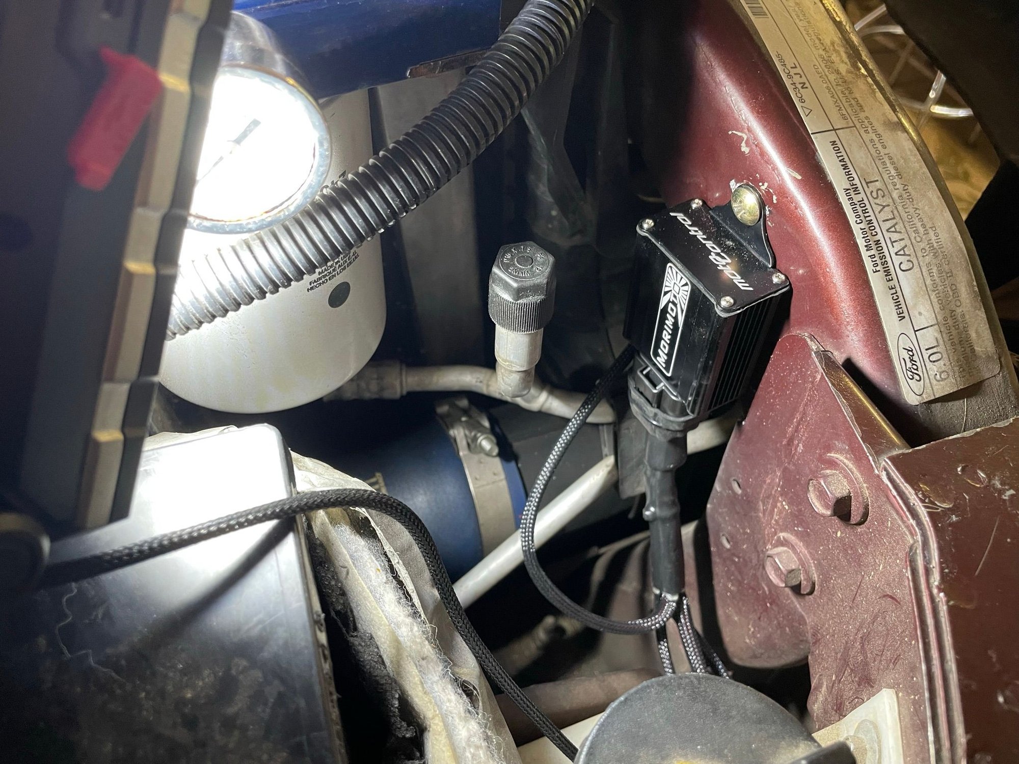

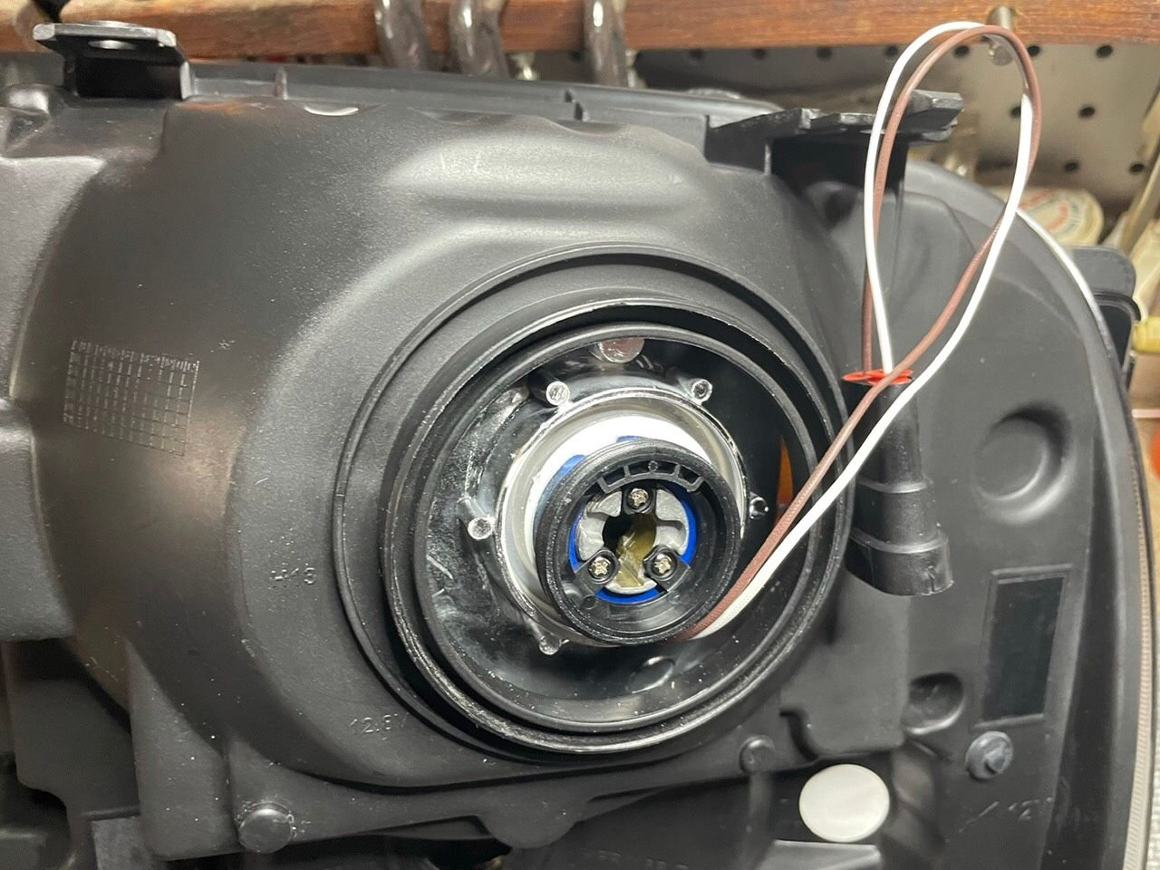

I got the headlights installed last weekend. What a difference! The high beams are amazing. I’m going to raise them just a touch but that about it. The line is at the bottom of the bumper on the car I’m following at a reasonable distance. I’ve seen some videos about measuring and all that but in the end it’s “take it for a drive and see how it looks”. Anyway, I like them so-far and they look good too so extra benefit there. Installation was a little more involved than I imagined, ballasts, harness, and controller and there was a little modifying required to get the bulbs in the housings he sent. The fog lights had a round hole that shoulda been square but a little filing fixed that. There’s not a lot of room in our trucks in the areas the harness will reach so the ballasts ended up behind the grill on each side, and the CAN buss controller over by the passenger side battery. They were all Ford style weather proof connectors but I got some electrical connection grease at the parts store today and plan to put a little of that in the connectors for added insurance.
