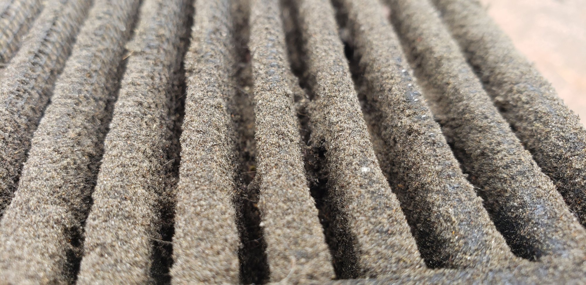

When I bought my truck ('01 7.3 RWD @ 235k mi) it was missing the battery box / air intake cover... I do have a lot of blow by in my engine bay, but I imagine lack of the cover made the filter get to this point much earlier. I obviously replaced the filter when I bought it, but I'm wondering if I should source that cover, or do you guys commonly run without it... Any reason why it shouldn't be there?

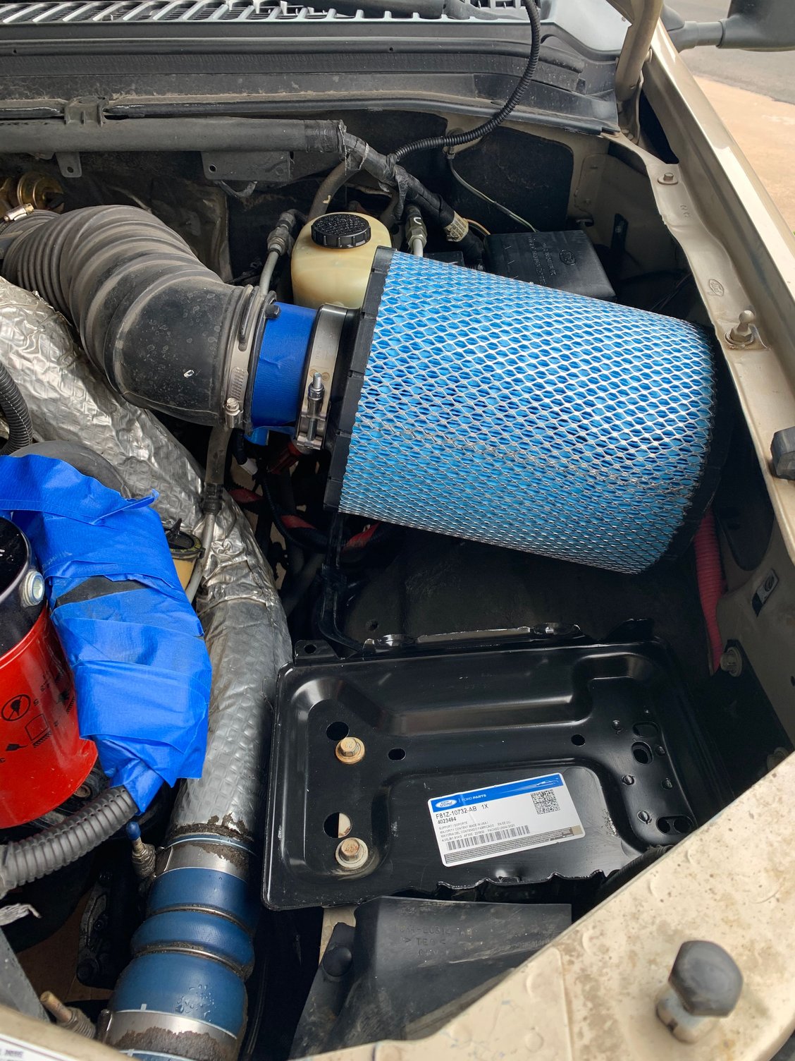

With an air box like that you are likely trashing your turbo and the rest of your engine.
Strongly suggest an easy fix with the 6637 as mentioned above. https://www.riffraffdiesel.com/riffr...37-filter-kit/ Good and easy kit. Suggest a new battery tray and all the old plastic will be gone.
Here is a photo of mine before I finished it up.
