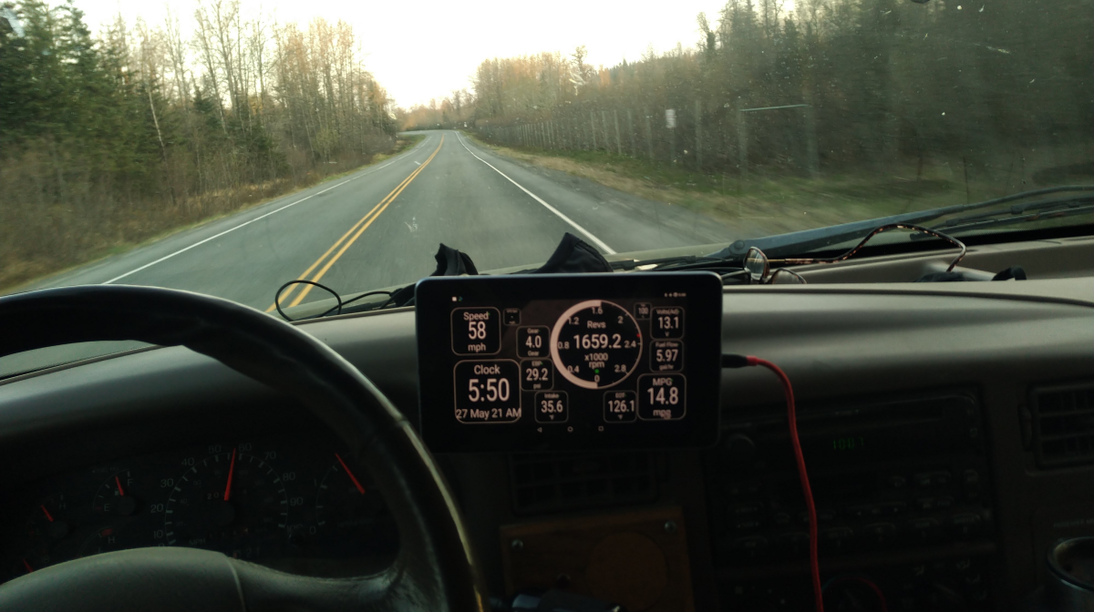

Driving to a nearly town, after 1.5 hrs of highway driving at 60mph, engine cuts out. First light to come on was "water in fuel", then all the other dash warning lights popped on. Restarted. Drove 3 or 4 minutes, repeat of this, only this time truck was running at a very low rpm when I got it off the road. I went under the hood and drained the contents of the bowl. Drove for approximately 5 minutes and had a repeat of this. This happened twice more...even swapped in my spare fuel filter, still the rig would run for 1-2 minutes then die. Made it to the Ford dealership in Kenai, they said it would be three weeks until there was an open appointment. Back out to the rig and noticed a red icon on my Android tablet which runs Torque via a bluetooth OBDII connection. There was a teeny tiny error message next to the red icon saying something to the effect of "OBDII transmitter malfunction". I pulled the bluetooth transmitter out of the jack under the dash. Restarted, and had no more problems for the rest of the day. The BT transmitter was purchased in 2017 and was manufactured by BAFX Products. Link to the unit is here:
Amazon Amazon
Be aware of this problem 7.3 guys and gals. I had a stressful 45 minutes until I got it figured out!

Just out of curiosity, were you running TorquePro as the diagnostic software?
I have had random engine stalling issues with TP as have other friends. Not just people I have talked with here on the forums, but people that I know personally and met their families.
That is only one reason why I and many others use FORScan or FORScan Lite now. FSL is not as pretty, but it is a much more robust tool and has much less "sabotage" tendencies.
BAFX is considered a reliable and affordable scan tool, but anything made or designed by humans can and will fail.

...Back out to the rig and noticed a red icon on my Android tablet which runs Torque via a bluetooth OBDII connection.
I'd suspect TorquePro before the dongle, based on some experience I and others have had (x2 Sous' comments) with that app killing the engine while reading DTCs from time to time. Consider setting up the FORScan Lite app on your tablet and using the BAFX OBDII adapter again. If the issue repeats, at least you know what to do to get going again.

Thanks for the responses. I've been running the exact same setup and configuration on the tablet with Torque since shortly after I got the dongle. There was a number which showed up on the screen after the first failure. Number was, "41008037888C". The service counter at the Ford dealership said this was not an error code. The configuration that I use shows OBD vehicle speed, GPS speed, engine rpm, transmission temp, voltage, exhaust back pressure, etc. All stock PIDs per Master Tugly's posts. The truck is my daily driver. The tablet stays hooked up on my dash on standby when the truck is parked. Picture below shows tablet before shutdowns started happening. No red "problem" icon in upper right.
