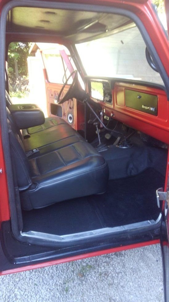

Yes I forgot to mention that I also got a cab/door pinch seam seal set from a mid to late 90's Ford truck in the junk yard. They have the metal inlay and seem to grip the pinch seam very well. They follow the upper top corners door opening angles pattern very well also. But where they come together (under the scuff/step plate) you have to trim off 6" ish. I did have to glue the lower back corner, that angle did not match. You can see the ripple of the seal on the lower corner, but it works.

any tips on a clean removal?

Just pop off/remove the scuff plate on the (donor) newer truck and peel the seal off, it was that easy.
Install time, start at the top front corner working your way back to the top rear corner, those fall in place just fine. It is the lower front and rear corners that need some work. And then cut some off the bottom to get it under your OEM metal scuff plates.
