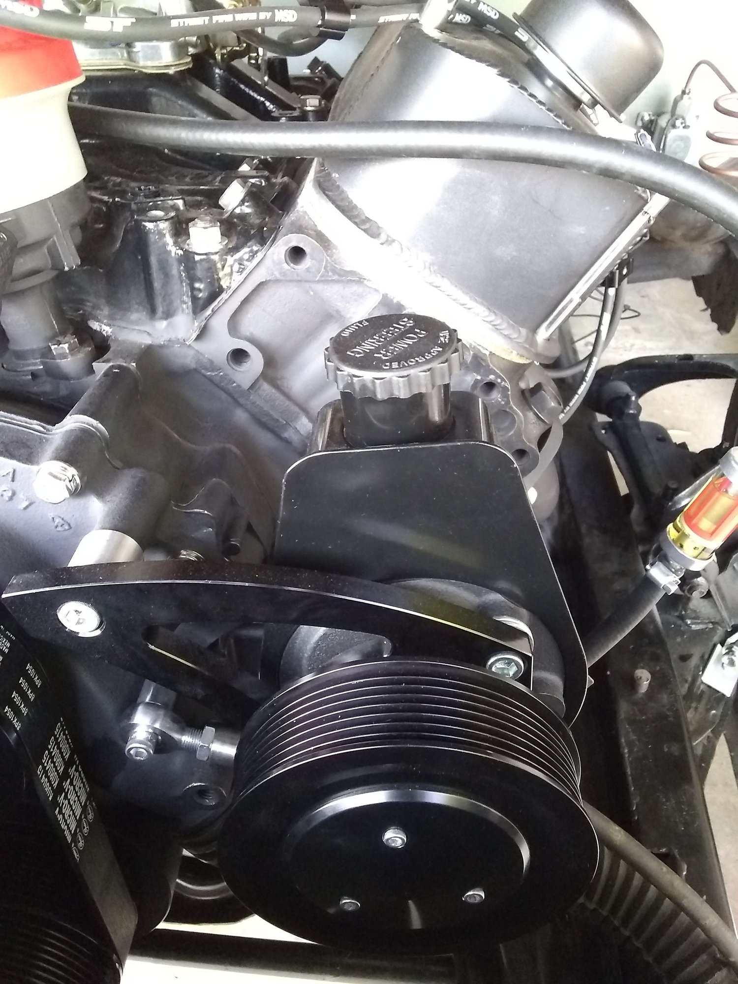

I have a GM Hydro boost running off a Saginaw P Series Pump.
My Question is can I just buy 3/8" High Pressure Hose and put 6 AN Swivel Seal Hose Ends on it or does it need to be made by a Hose Professional for proper seal?
Also if you know what are the Thread Sizes on the PS Pump Outlet and Hydro Boost Inlet?

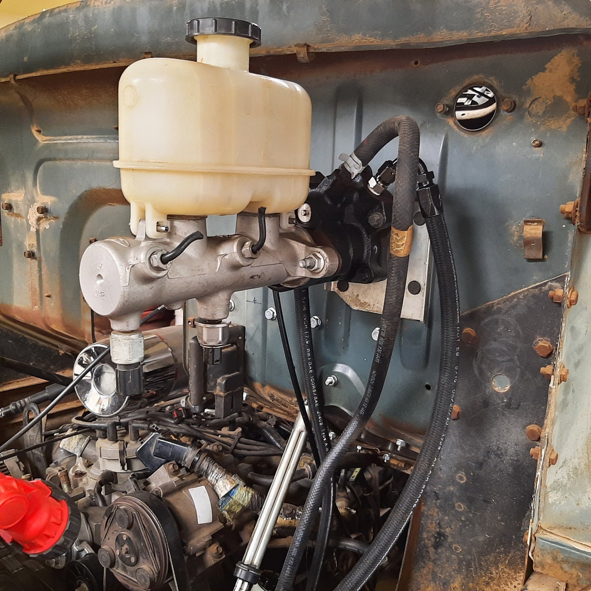

Earls makes braided line with steel fittings for power steering/hydroboost applications.
I just finished plumbing up mine using a Ford hydroboost and pump. The Ford had metric sized fittings and were available lots of places.

That's cool. I would have used OEM hoses if they fit nice, but the master cylinder on my COE is up much higher than a regular pickup. My son has a hydroboost on his early Bronco and used braided hose. It works well.

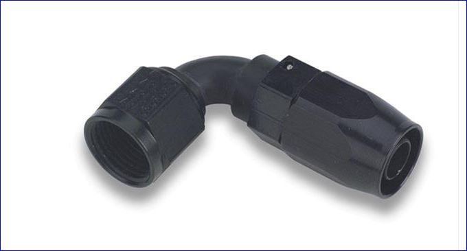

I went to a Local Hydraulic Hose Company and here is what I ended up with. The Reusable 90 degree Fittings were $34 each and the Hose was $4.60 ln ft.
Does not seem like the Best Price but it solved the problem and I know the fitting works with their hose.
The Clerk says the fittings can hold up to about 3500 psi and the hose 2250 psi so I should have no problems.

Should work good. Looks good too. 👍

Thanks, tightening down four fittings was a pretty good workout. Makes me more confident they will work great!

I agree. The tight fit of the outside nut, and the inside threaded fitting made me confident it would be a nice safe connection.
