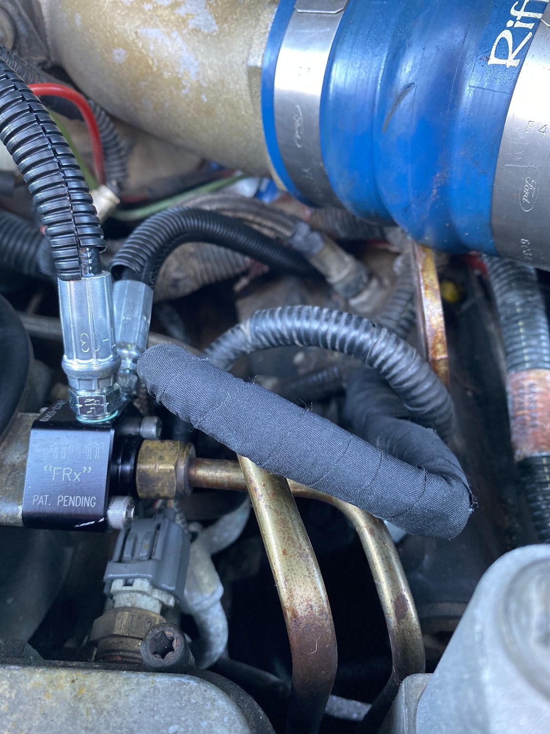

I’m installing my new FRx and have the passenger side hose installed but there are no pictures on the instructions of where to route the drivers side hose. Do I have it routed correctly?

That's how I routed mine.

Perfect. Thanks!

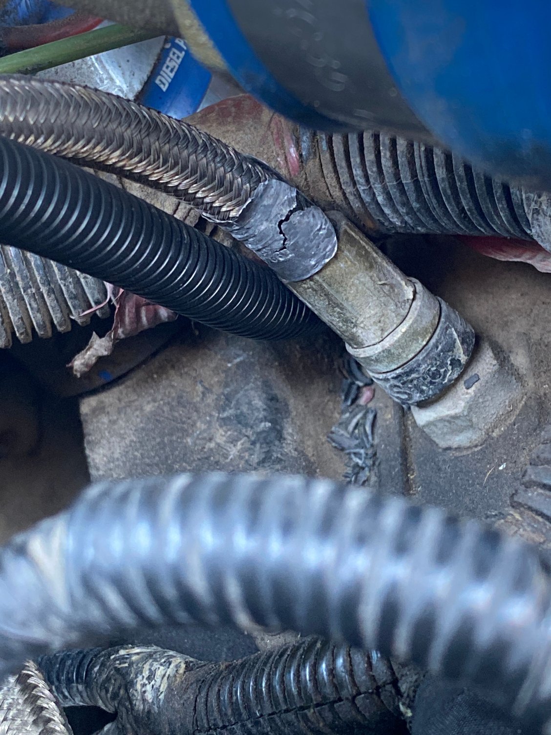

Where it gets close to the HPOP hose I'd slide on a bit of rubber hose for protection. SS lines like that will eat right thru if it is in contact for too long.
Or crack open the wallet yet again and get the new design HPOP hoses with rubber coating. HPOP hoses fatigue and if it pops you're coasting to the side of the road.

I’ll put some rubber hose on it.

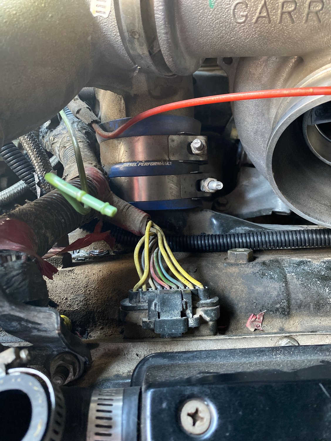

Check the area around where you were working. Tin nut on IPR, IPR connector, CPS wire, ICP connector, wire sheathing for critical sensors, etc...
You may have a wire coating that was on the verge of going bad and you disturbed it causing an intermittent fault.
What about the 42 pin over the valve cover?
Air in the system would make it shudder a bit, but your fuel pressure seems good.

Did another run, this time about 20 miles and the truck never died. Tin nut looks good, all sensor connectors seem solid. I wiggled them around with truck idling and nothing happened. Weird, but seems to be gone.
