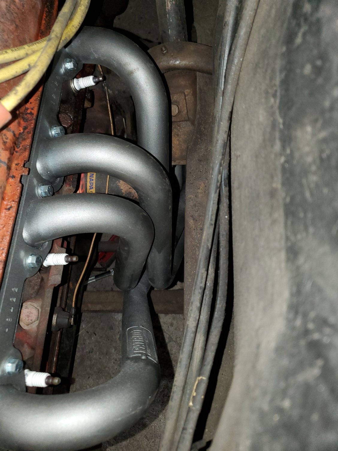

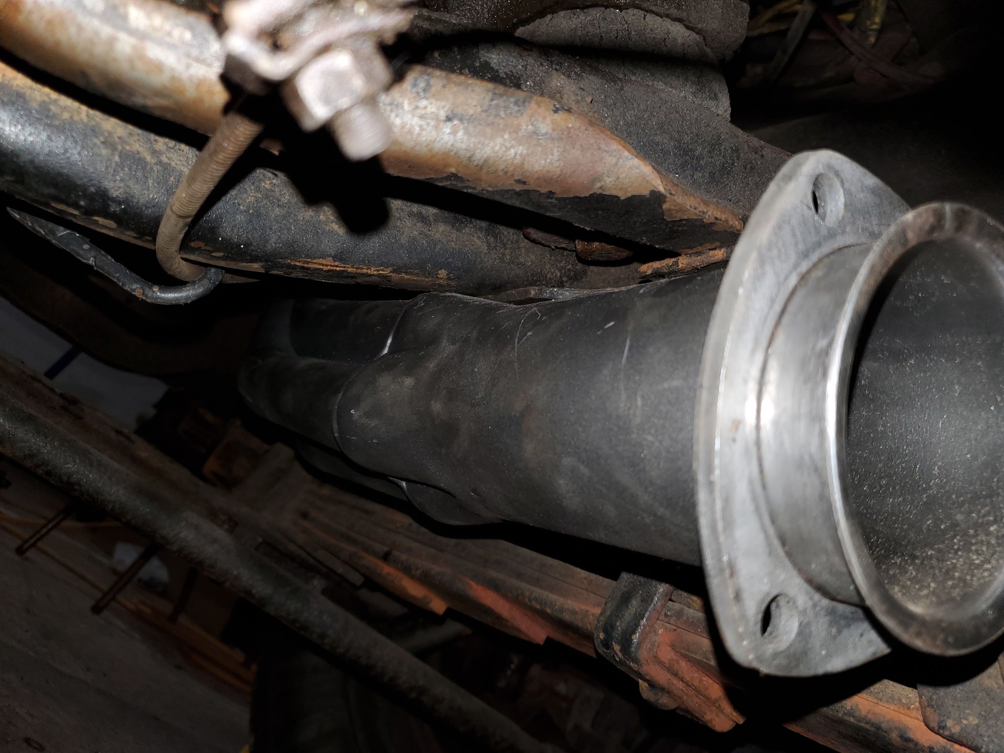

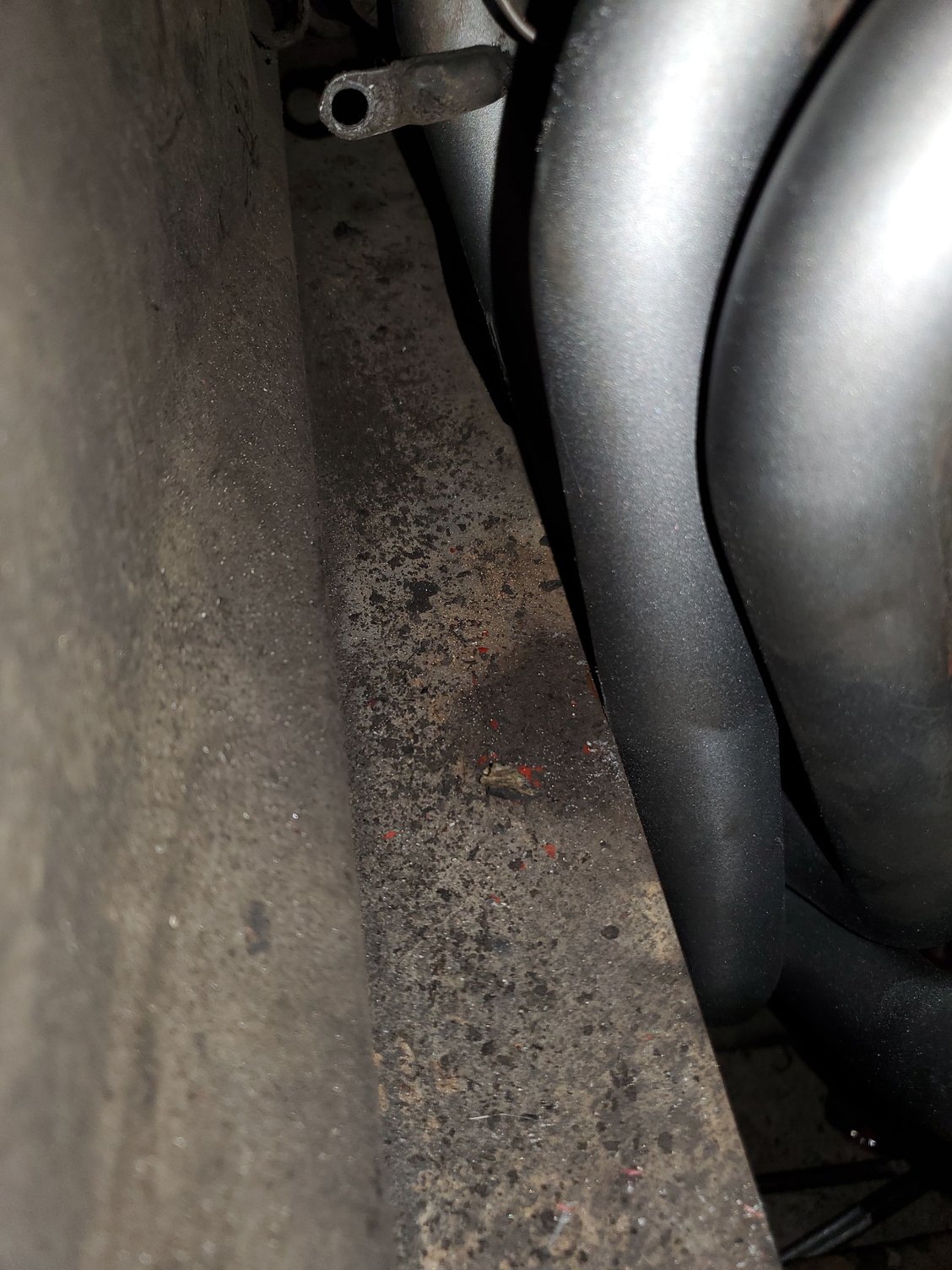

I have 1964 F350 with a 292, while the WD 40 does it thing does anyone know if the mounts for the engine and transmission have any side to side movement? I installed some patriot headers that are listed as fitting, one side has at least 3/4 inches of clearance and the other side is touching the frame. It is also touching the transmission crossmember, figured I'd try to see if I can get it to clear by lifting the front of the engine slightly. Hoping it has some side to side play to see if I can get it to clear the frame.

Crossmember, transmission support same on both sides
Passenger side touching frame
Drivers side lots of clearance

My two 1966 F250 4x4's both use the front and rear mounts. One 6 cylinder and one V8. 3 touch points - 1 in front and 2 on the bellhousing. Once you place the engine you have to pass bolts through the frame, insulators and mount. There is not much wiggle room. I use a larger phillips screwdriver to line up each hole before installing the bolt for each.
