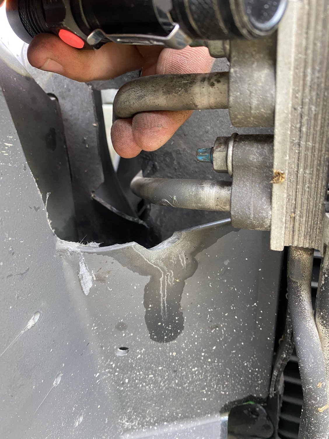

Need help with a part number 2004 F250 6.0 auto 4wd dual alternator. Looking for a part number for the line that comes off the ac condenser. I can only find the one off the compressor

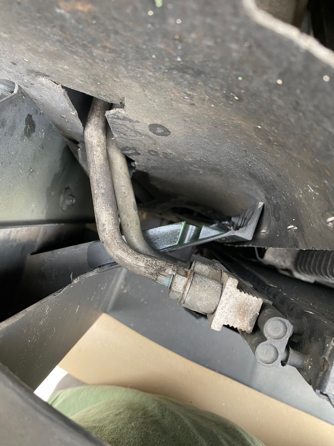

Found the line goes from the bottom line of the condenser to the orifice tube

The dual alt has a different line to make room for that lower alt.
So be sure to use your vin number when ordering to get the correct lines.

This is the line part number I recently received from rock auto for my a/c overhaul : https://www.rockauto.com/en/parts/mo...rant+hose,6900
Part # YF38013
It is different than my OEM ( I have a single alternator) but the bend would surely clear a second alternator, since it now will sit BEHIND my CAC tube where it used to sit in front...... or they superseded this and eliminated my OEM hose since it will work.

FYI that line worked perfect for my application....never heard from you so not sure if you're still interested.
