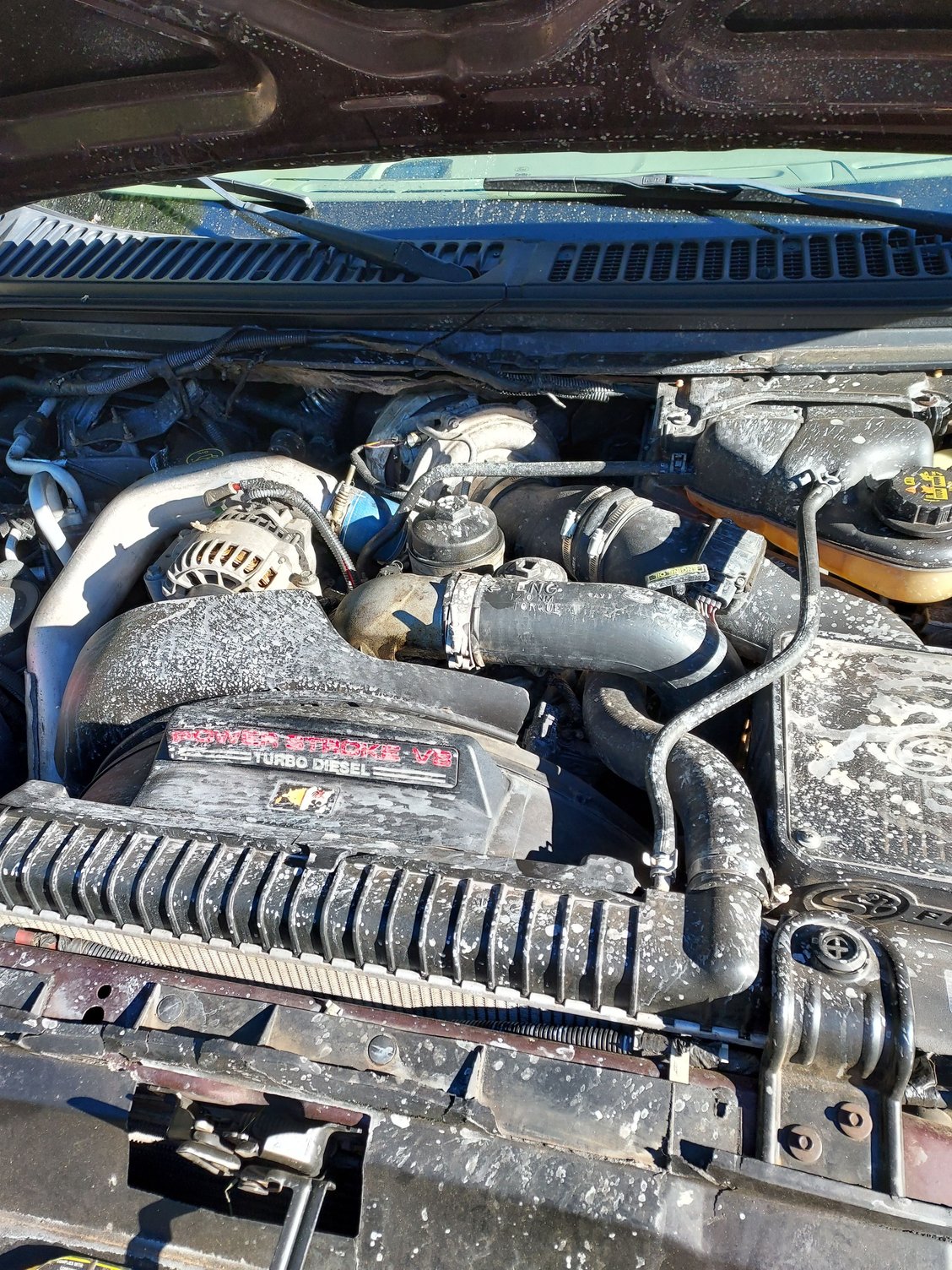

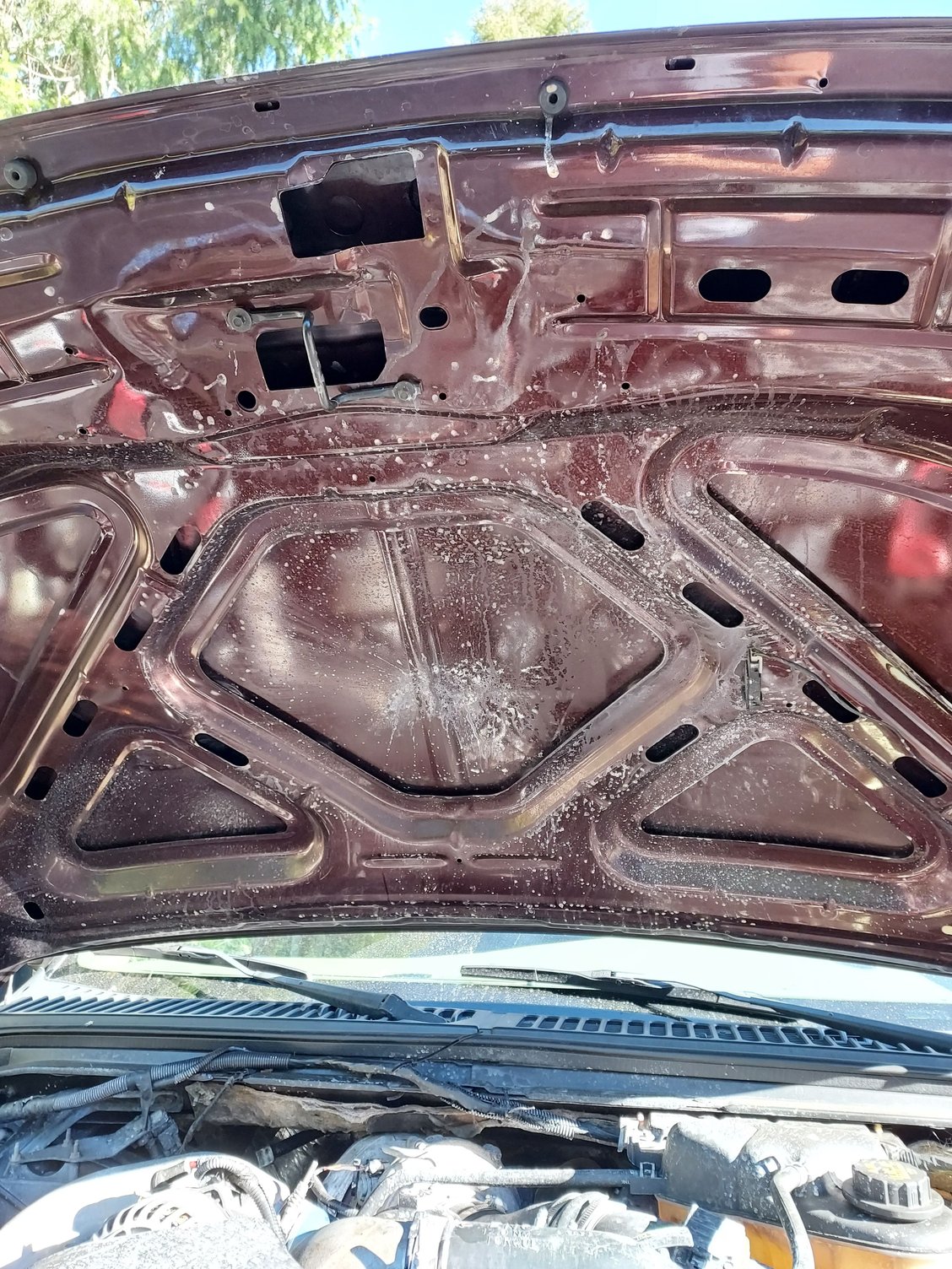

I wasn't even thinking about the fan and the fact that it could spray coolant all over the place.. I could even have a leak in the radiator. It only seems to happens under a large load. Cleaned the hood and engine last week. Towed a large tractor Saturday and it sprayed again. I was watching my coolant temp and it got to 220. EOT was 228. This was up a good grade.
Here is some pics.

Oh my. You do have a leak. But it doesn't appear to have affected your engine yet - those numbers aren't bad towing up a steep grade, and it doesn't appear to be blowing out your degas cap. It seems to be everywhere, even above and in front of the fan shroud. I'm guessing the top radiator hose or radiator top tank, but there's so much everywhere that Jack is prolly right. Maybe from somewhere with more pressure.

Looking at the splatter on the hood, have you checked the small hose that connects to right side of the degas bottle. Could have a split/hole in it that only opens under heavy load.

I would not discount a head gasket issue. You might have a weaker point that will "blow-off" at a lower pressure than the cap. Looking at those pics, maybe the radiator seam.
