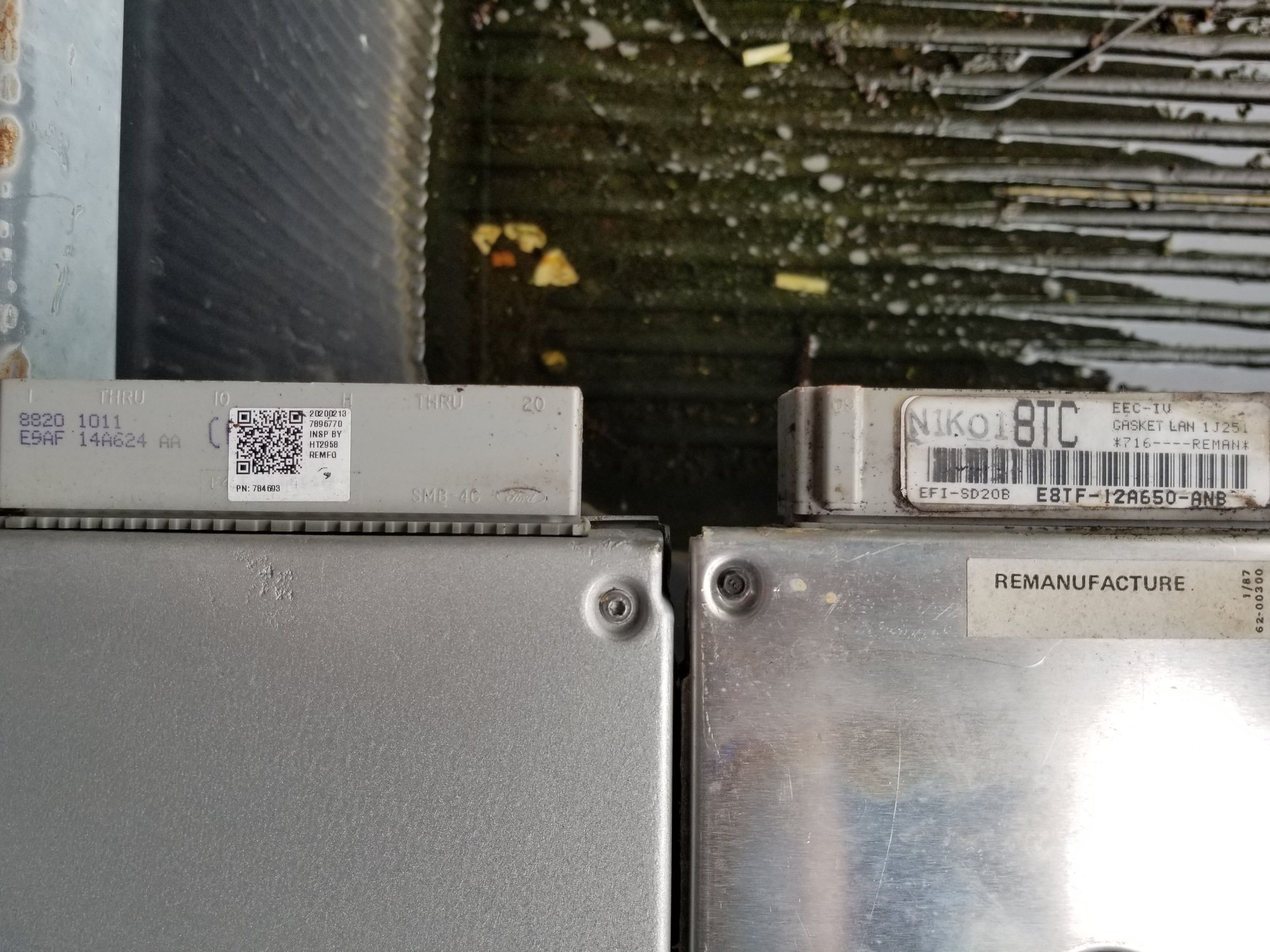

Alright, got the fuel line fixed and the injector pig tails taken care of. Still no injector pulse, so decided to buy a new ECM, which I just picked up from the parts store. The guy at Oriellys said the ECM may or may not be programmed - it's more or less a crapshoot. Is this true?
It is my understanding that these can not simply be programmed or flashed at a dealer because the program is already burned into a chip from the factory, hence the reason I provided the numbers from my old ECM.

Ok, installed the new ECM and still no injector pulse. Guess the question now is, is the new ECM not programmed liked the guy said could happen or is my original ECM good. How would I know if the new ECM is/isn't programmed?

They are already programmed for the specific model and configuration. At least the Cordone units are. Are the numbers on the new one the same as your old one?

The one I picked up is a Cordon. Oriellys entered the orginal ECM number (E8TF-12A650-ANB) in their system, which interchanged to number E9AF-14A624-AA.
The ECM on the right is the original.

Try the test you did on post 48 and see if you are still getting the 10 volts that you should only have 5 volts on. That may help someone with electrical skills.
https://shop.advanceautoparts.com/p/...er%20pcm%20emc
The number you posted for the PCM does not show as the correct one on the O'Riley web site.
The one in the link seems to be an exact fit if the transmissions are the same. The PCMs need the correct transmission (auto or manual) to function and you don't want a California one also.
