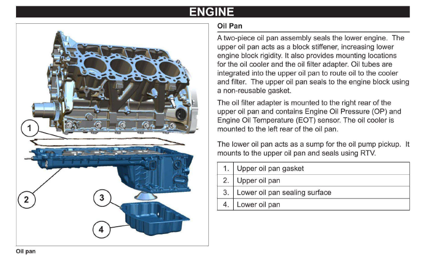

Did they change this starting with the 20's? According to the coffee table book, page 24, there is an upper oil pan gasket.

Yep, and apparently it is not backwards compatible.
