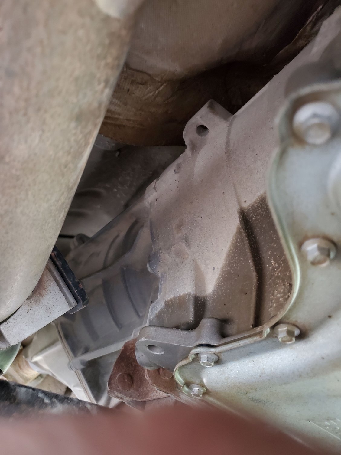

While I'm at it I guess I should put some pictures of underneath. I just got underneath the truck found some wet spots. You feel a little oily so I'm wondering if I've got some leaks somewhere. Is it normal to see you a little bit? I know that they were underneath changing the upper oil pan so I don't know if I got a little messy or what but I guess it's something I'll definitely keep an eye on
Edit: it's been a little wet around lately though so might just be from puddles. Definitely something I'll watch
