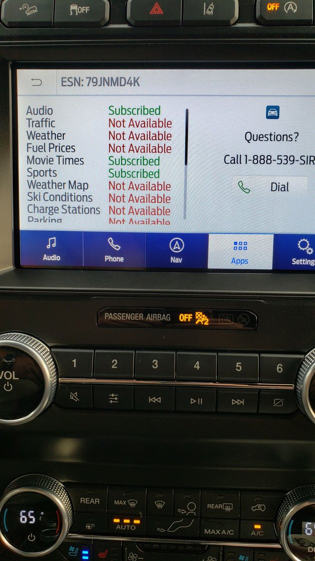

Took a short trip to the river with the dogs. Travel link not working again.

well heck. after a week my travel link quit working. apparently the system somehow upgraded to 3.4.21020. not sure what strategy to try now. take to dealer perhaps.
I had the auto upgrade feature disabled.

Dropped the truck off at the dealership this morning. Service writer called back this afternoon. Says technician detected a bad board/module. Ordered a new one. Might be a few days.

Anyone figure out a solution to this issue? My 21 Expedition is doing the same thing. I have Sync ver 3.4.21020. It just started recently. I know it worked after the last update and then at some point after it stoped.

Dealer said issue with sync module and ordered replacement. that was about 5 days ago. they said the part is in stock at the factory. I will be following up with them next week.

Fixed...for now
Took my 2020 Explorer to the dealer. Told them my Sirius Travei Link not working. They found that the APIM was not properly calibrated. Also performed a Sirius update. Has been working fine for a week.

Got the truck back from the dealer yesterday after them replacing some sirius related module. Looked good for about 4 starts and no longer appears to be working.

Seems there may be a Ford resolution for our problem here - TSB 21-2150.
This technical service bulletin appears to address our issue right on the nose in addition to a few more.

Ya, that's my fear, a waste of time. I'm hopeful they will find a solution and dump it through the automatic updates. Hopeful, but low expectations. Actually disappointed I paid $500 when I ordered my truck and included Navi, I only will use Google Maps, and only like the travel link to show traffic on my daily driving. That is now gone (hopefully temporary) but I have no high expectations. Let us know if / how you ever sort out if you do, thanks
