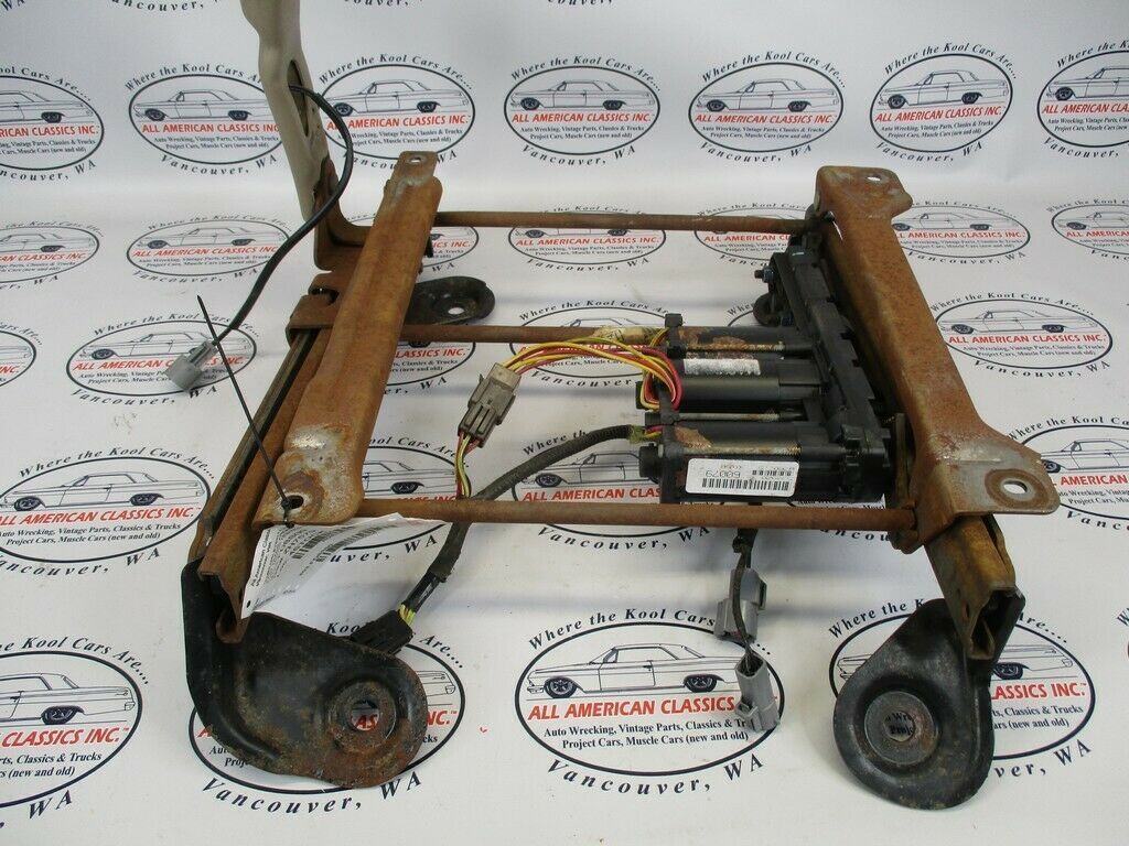

You might be able to remove the seat to carriage bolts which takes the seat off the track frame. Something like a 10mm bolt. Pic from Ebay listing to show.

Also, the inner rear is a nut on a stud (5/8 or 11/16, I can't remember). You should be able to take that off with a wrench. The Torx is T55. You might be able to put a wrench on the part of the Torx bit where it sticks out of the bolt head and turn it that way. Spray some PB Blaster on that Torx bolt from underneath the truck beforehand.
