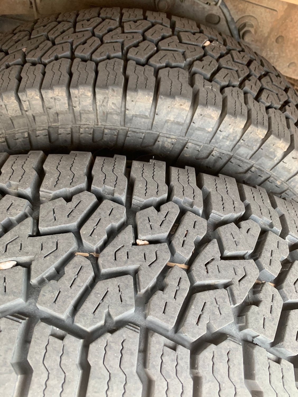

Im actually driving the truck today, I have 14,981 miles on them and they’re sitting at just over 10/32 tread.
Here’s a picture of them as of today...VERY even wear. The traction as been outstanding in snow and wet conditions. They are very quiet too, I’ll definitely be buying them again.

Doing some math from Colorado's post in 2019 and todays. Don't know if my math is correct or not but here is what I get for tire ware.
2019 post at 10,396 miles you said you used 4/32. So
10,396 divided by 4= 2,599 miles per 32 used of tire tread x 17/32 new tire depth= 44,183 miles for the life of the tire and that's running them bald. Not terrific mileage but gets worse using your currant numbers.
14,981 " 7 = 2,140 x 17= 36,382
don't know if anyone out there has info on how long they ran there Falkens for a true mileage comparison Some on here said they have gotten 70k on their Coopers which makes my point earlier about the up front savings vs the long term mileage.
