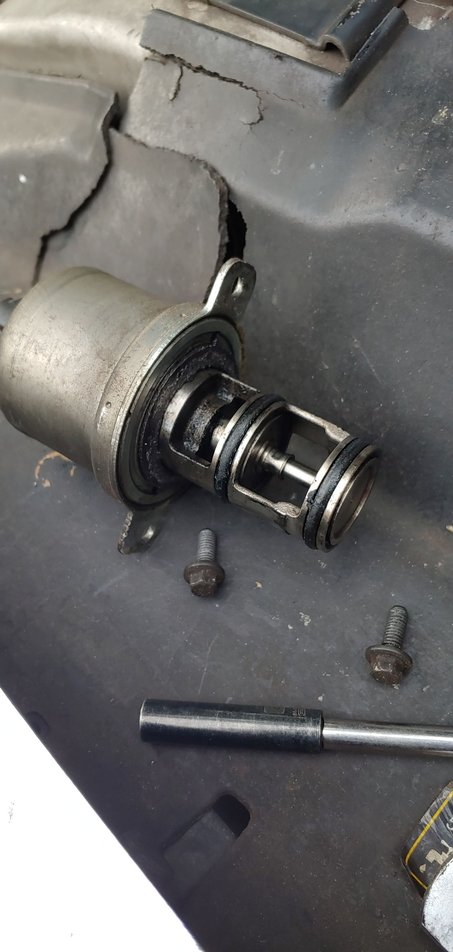

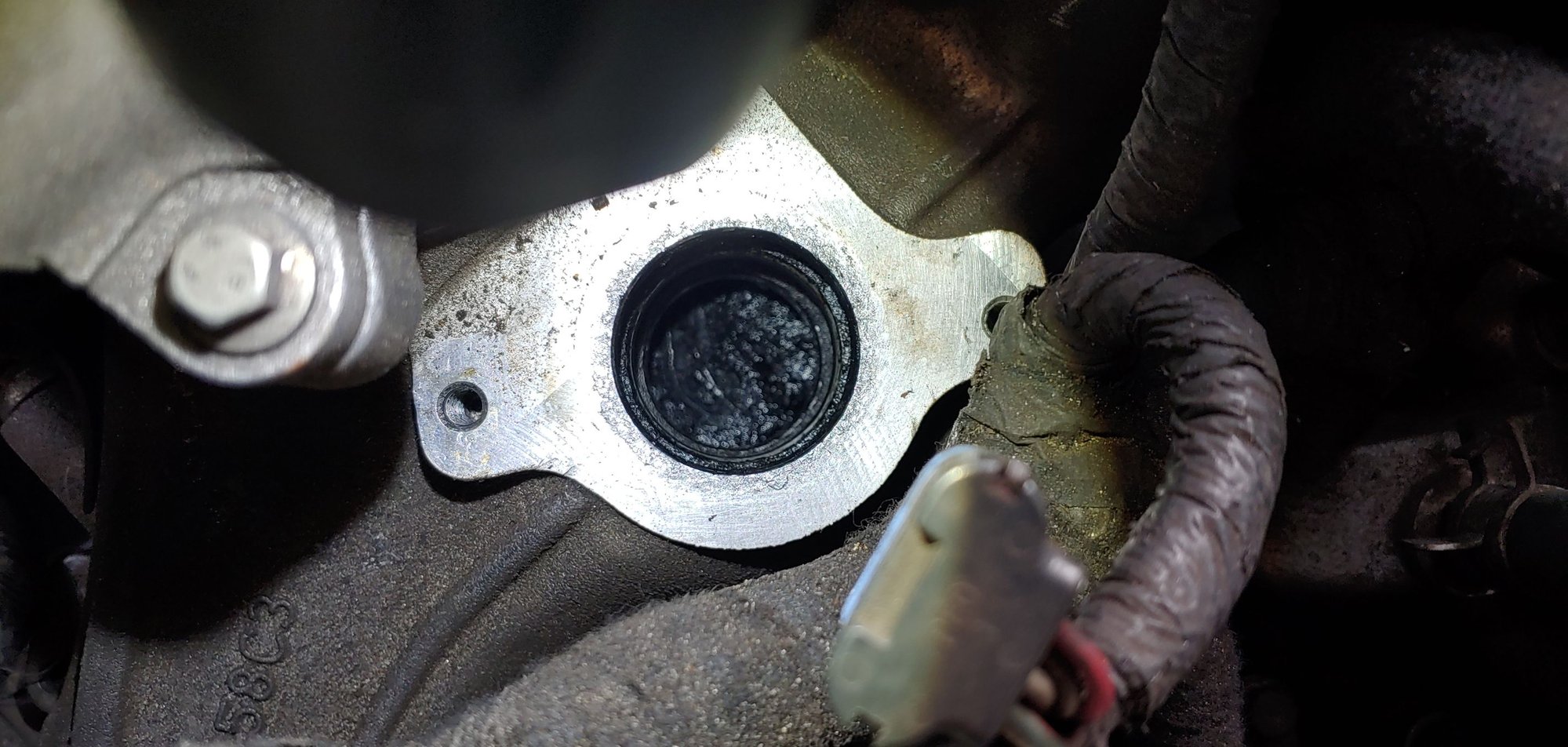

A little worried now. EGR valve valve was clean but the bottom of intake was a little moist. I have a welded delete on it. Y'all think it's possible the weld sprung a leak.
also put truck back to stock. Excessive black smoke gone. Gonna try a low tow tune and see what that does. If I don't carry a tune I have the speed limiter on and my tire size goes to stock size tires. I'm running 31.5 h tires and like the Speedo to read the Wright speed.
