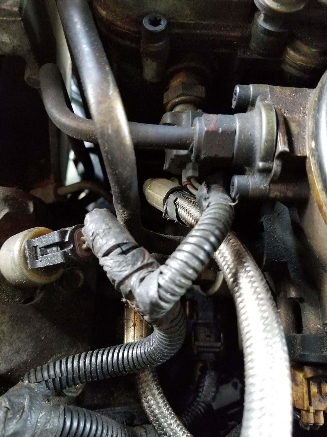

I cleaned everything up yesterday, then getting it drained, and let it dry overnight. So I drove it around a bit today and it appears the leak is coming from the front as I see some fresh oil coming off the lines and/or fittings that go into the HPOP and maybe some on the IPR. I cannot get a look at the non serviceable plug on the bottom. Any input on that plug would be appreciated!
The turbo pedestal does look dry, though it has caked oil residue on it. I will continue to keep an eye on that area for fresh oil since it is somewhat clean.

Sounds like a good time to change those hpop lines and fittings if they haven't been done yet. Hpop lines are known to burst and make a absolute mess out of the engine bay. Riffraff or cnc fab make quality lines with jic fittings. Or you could just change the hpop fitting orings depending on where the leak is coming from.

They aren't leaking at the heads and I need to take a closer look at the connections to the HPOP as more worried about that non serviceable plug given read it likes to leak...
