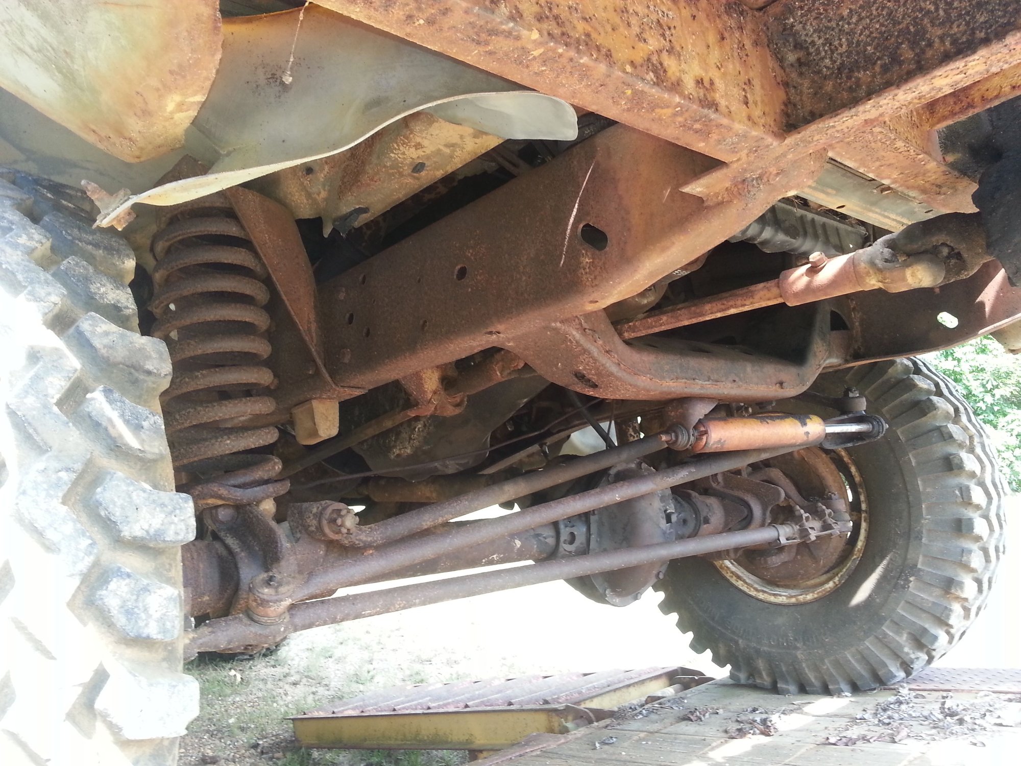

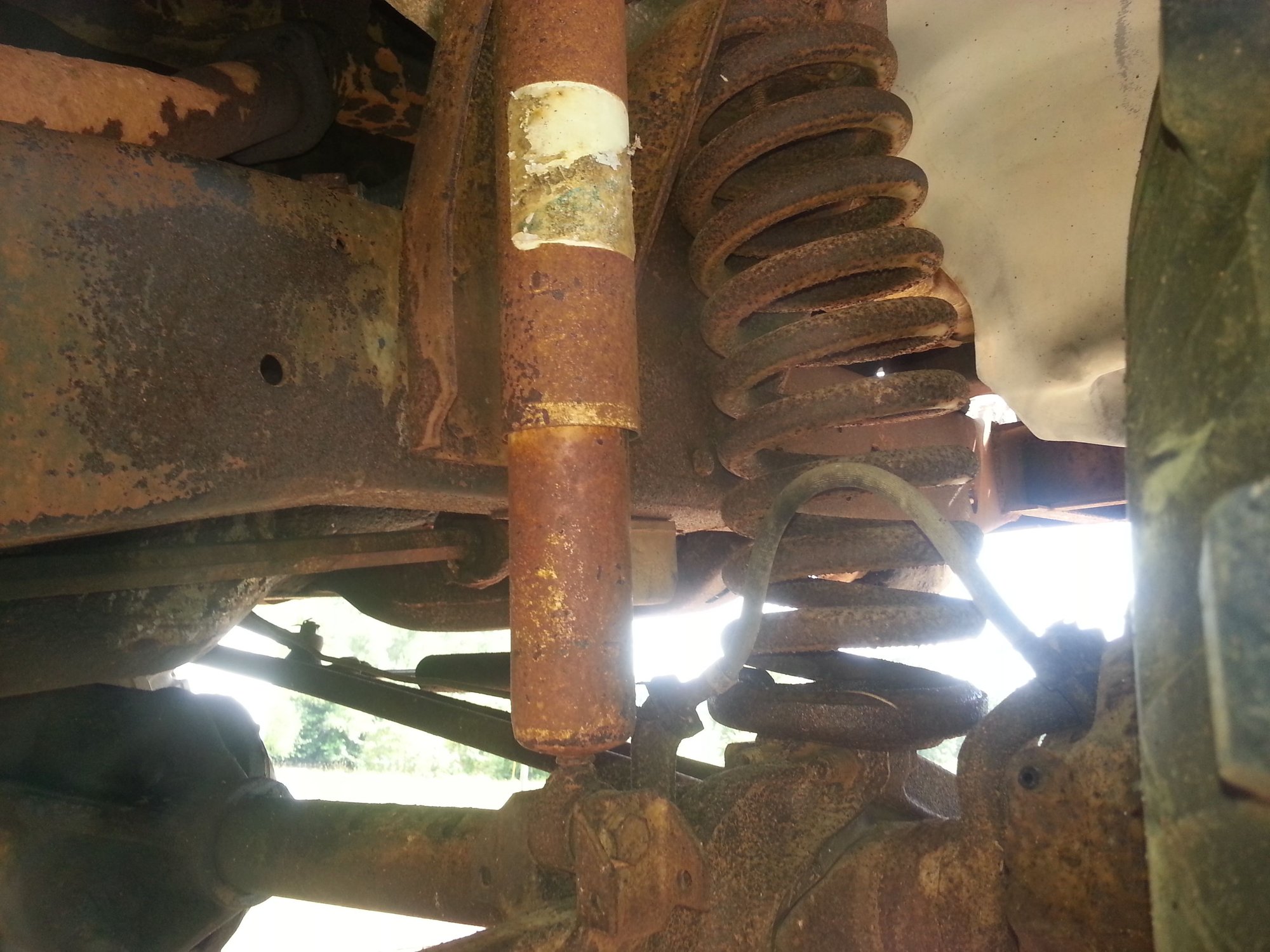

My father in-law installed some coil springs from I think a 1 ton (not sure if from a Ford or not) on his/our F150 soon after he bought it in 78.
He put a big *** front bumper/winch on it. It gave it about a 1.5 inch lift in the front as well.
I'll check with him to see what the springs came out of.
Front bumper and winch

Originally Posted by John89
Yikes, that spring does not look safe.
