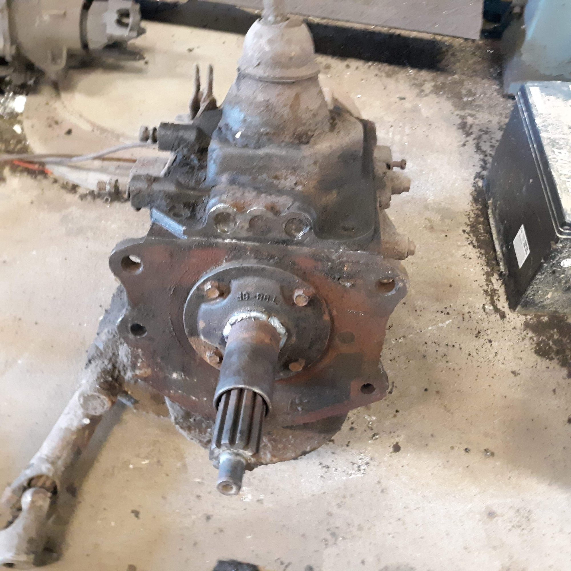

Hi Folks ... looking for some help. Thanks to previous advice from the smart guys on here I have managed to locate a T98 synchro silent 4 speed tranny for my 49 F68, but unfortunately I do not have the bell housing. Given that the tranny I removed from my truck is a T9 which has the clutch housing as part of the tranny case, does the bell housing I require bolt from the tranny to the block? Or do I need a hogshead which attached to the flywheel housing that I already have? Below are photos of the flywheel housing I have plus the two trannies. Thanks for any help.
This is my existing flywheel housing
This is the T98 I want to install
This is the T9 I removed

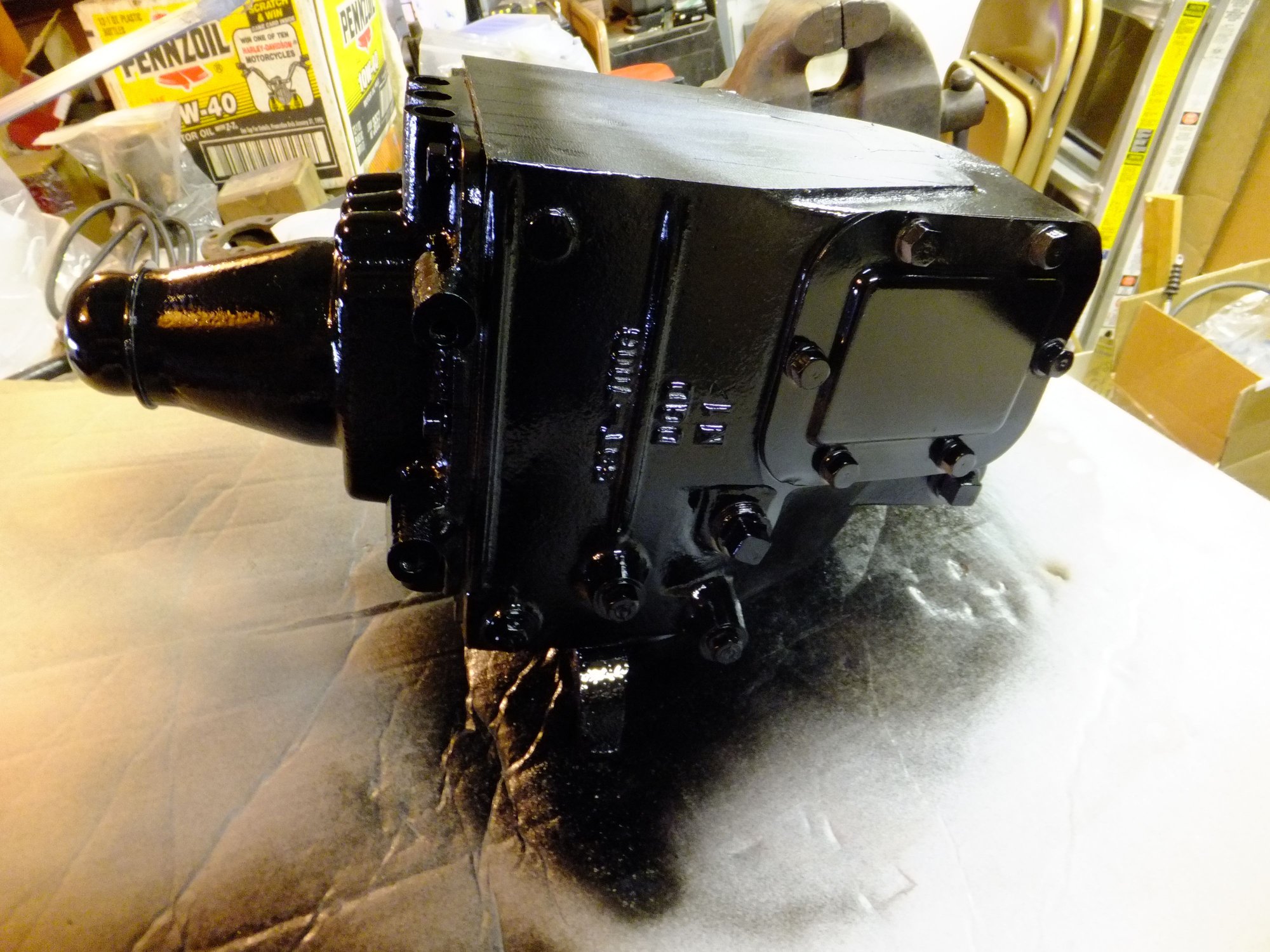

I believe that the part of the bell housing that is on your T-9 is removable and would possibly bolt to the T-98. I believe the bolts are inside the bell. Here is a picture of the two parts of the bell housing bolted together for paint.

Sorry, Rich, posts were overlapping. The T9 and T98 use different bell adapters. The bolt pattern is totally different on the trans end. Neale has an early Canadian version T9 which does not have a removeable front section. It was originally designed to bolt directly to the back of a 59AB engine. Canada used the old style case for much longer than US production.
you are correct Wayne, the T9 clutch cover is an integral part of the transmission and used this flywheel housing to adapt to the motor. So I’m not sure if I need just the clutch cover to adapt to this housing or a larger bell housing which connects tranny to motor.
Hi Rich, the clutch housing is an integral part of the T9 tranny. But your first photo appears to show the piece that I need, that is, the housing between the tranny and the flywheel housing which I already have. Any idea what you call this piece? Is this a hogshead adapter?

Yes, that's the hogshead.
