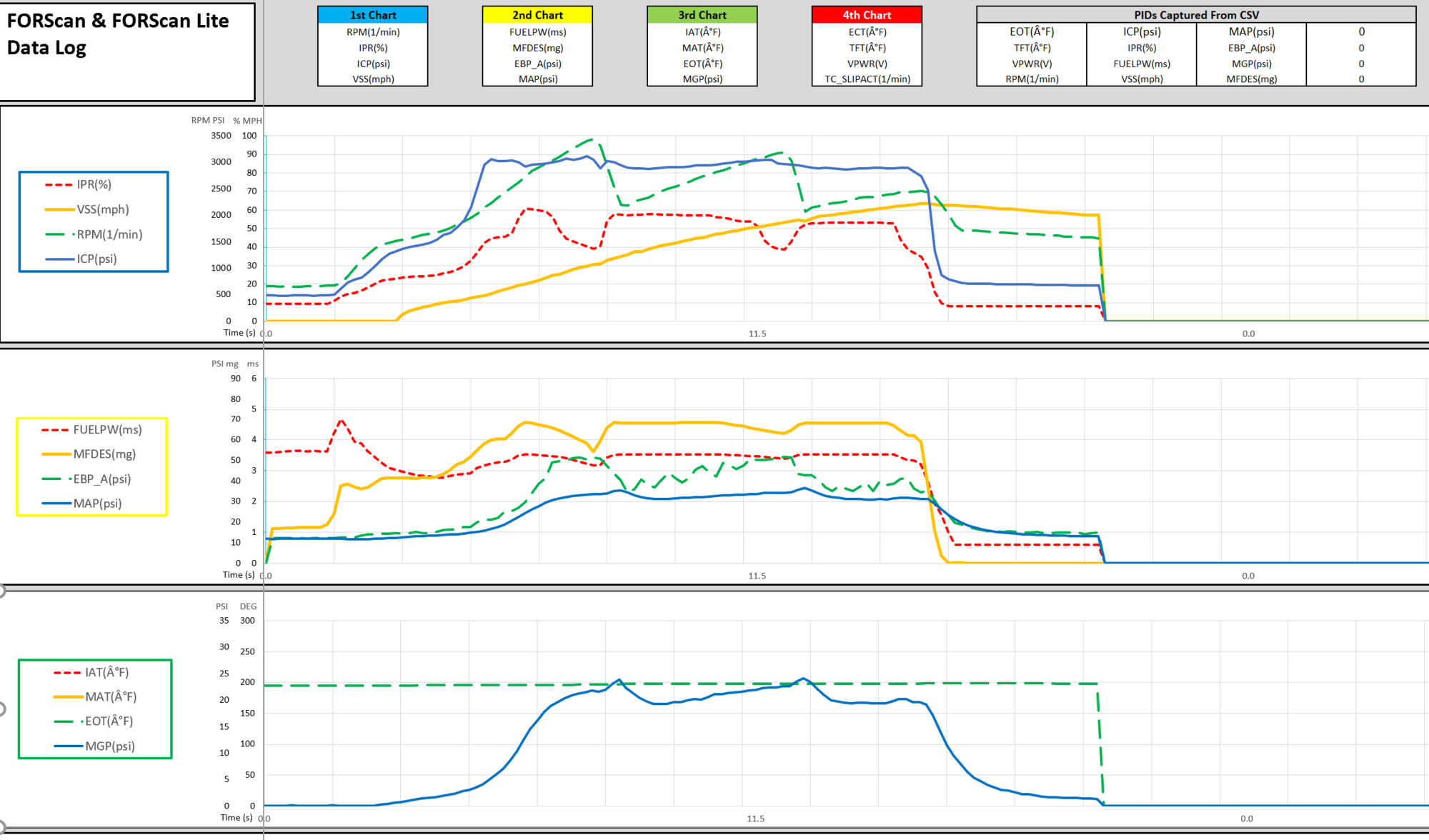

I have some more data, and am interested in your input. After this morning's test run posted below, I ran a boost leak test. What does this look like to you guys?
It seems fine to me. If you compare how long it takes to go from 25psi to 15, I count 25 seconds, and that doesn't seem out of line with KCTurbo's "after" test in their video. After this test, I used enough soapy water to make a decent bubble bath, and found a tiny leak at the MAP sensor, but fixing it didn't seem to make any difference. Also, per my discussion with @RacinJasonWV , above, all boots, pipes and plenum's were bone dry before and after the run, and that after 800 miles on a clean motor running up and down the Rockies. Can I confidently say I don't have a boost leak at this time?
Even if that's true, the test run showed disappointingly low boost for a "60H" tune (and the same one I've been running for years):
As best I could tell at a glance, EGT's topped out at 1100+.
EBP bounces around, and I noticed this morning it does it with KOEO, too. MAP and BARO will sit solidly at 11.5psi (remember my altitude), and EBP bounces between 11.6 and 11.7psi. I've cleaned the sensor and tube twice since May, so if this is aberrant behavior, replacement of the sensor may be in order.
I've attached the data file, and am interested in what you guys have to say. It seems like with my list of mods, I should be seeing more boost lower in the RPM range, less smoke, and better performance.
Mark

Mulling over your data here. Does the smoke you experience at shift points clear up as rpm climbs? Reading other's experience with the KC300X turbine - it typically does not spool faster, due to it's higher weight, but it should provide higher boost at a given engine RPM compared to the stock turbine once it does spool.
I think your EBP sensor is fine. My EBP reading is already higher by a few tenths of a psi from MAP/BARO as well.
It looks to me like you did gain almost 2psi of boost with the new setup. I think it's hard to see though with a WOT run. If you could do a steady tow at a few different rpm points, you could see this gain better.

Not sure if your leak check is normal. Doesn’t look too bad to me but mine seems to be super sealed now. I think a big difference between the bad and good on my truck was how now it basically stops at 10psi where before it would just continue down at a similar rate. Really wish I’d have taken a bad video now…
Like BWST I think your EBPS is fine regarding the slight fluctuation with KOEO.
I did notice it sort of varies during your charted run though. Is it possible the wastegate is partially opening? Just a thought.
I don’t know how the ported housing may play into this. Does it up the usable powerband any? I know your elevation is a factor as well.

Jeff and Jason, thanks guys, I appreciate your input. The fluctuations in EBP are odd to me, too, and the reason I was thinking the sensor was suspect. The wastegate is wired shut with a Turbomaster controller, so it can't open. I can't find a drive pressure leak, and it appears to top out the sensor's capabilities (51psi, right?) during a WOT run, so I'm thinking that side is good. Jason, your videoed boost leak test is extraordinary. Could it be that your valve seals, and perhaps piston rings, are in particularly good shape? That seems to be where most of the air escapes when doing these tests.
Jeff, yes, the smoke does clear up as RPMs increase, but it's unquestionably smokier now that it used to be in the same tune. I do need to strap a load on this thing and tow it up the hill to know how it's really going to work. My suspicion is that I didn't do myself the good I was looking for when towing (e.g. lower EGTs being the biggest thing) by swapping turbines, and that I may have gone backwards. We'll see. If that's the case, I can either go back to the stock turbine, or fire off a Buck$ooka round and try a 4+4 wheel to get the improvement I was seeking. I have no idea how that would play with the ported housing, though.
