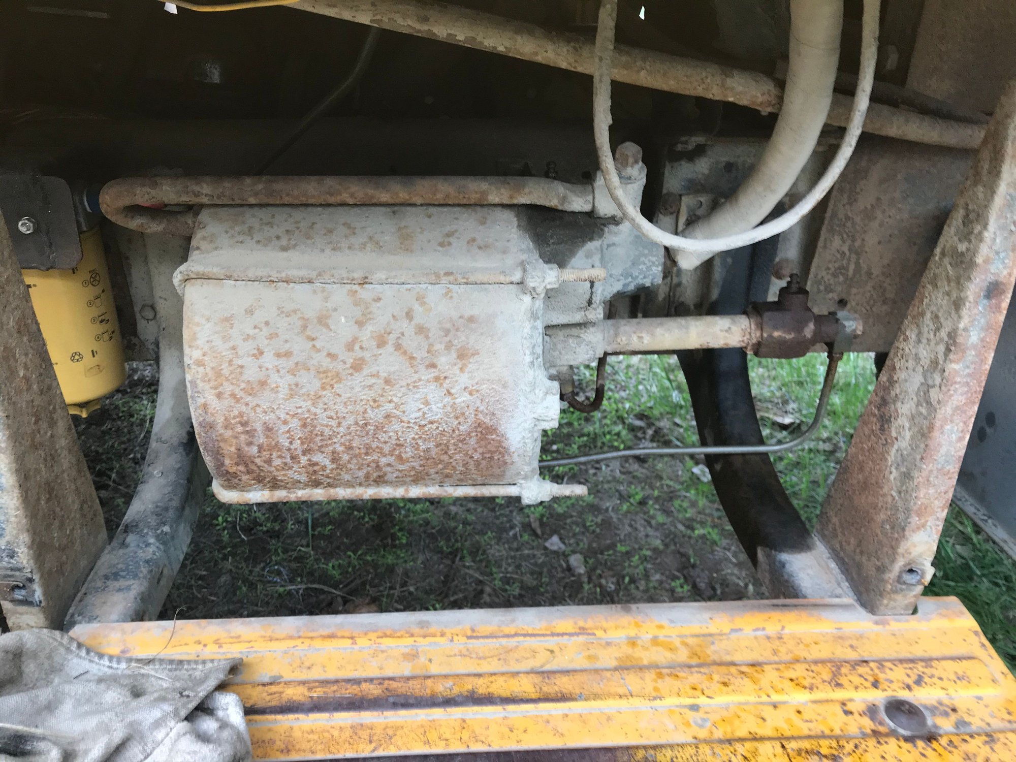

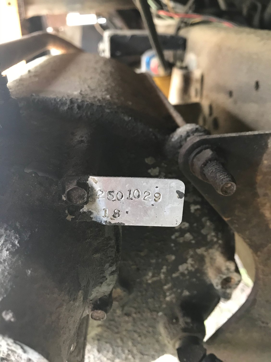

Over the winter, the brakes on my N700 went out while plowing snow. Fortunately the road I was working on was very rural so there was no other automobiles around when it happened. Also, it is handy to have an extremely heavy anchor bolted to the front end lol. So, I am in the process of replacing the master cylinder and wheel cylinders and have run into what I think is a weird development. The hydrovac on my truck is a frame mounted piston style bendix 2501029 (stamped on the id tag on the unit). This does not seem to be the correct booster for my year and model. Before I go searching for a new or rebuilt one, what should be on there?

Current booster
ID tag on booster

Why do you think it's not the correct or OEM booster?
Did it work ok before the failure? Was the failure caused by wheel cylinder leaks? Or something else?
That unit appears to be available:
https://powerbrakes.com/2501029-hydrovac/

I referenced the Ford master parts list and although I could find this part number, it was not listed for my particular truck. I think it was for an F800 or 850? The one listed for my truck was a smaller diaphragm type. Having said this, I do not think that I have ever successfully navigated the ford master parts book without the help of Numbers Dummy. LOL.
As far as the booster working before the failure, yes it was. Everything was acting normal, then no brakes at all. First pump I noticed was soft, the next went right to the floor. It acted like a broken line. I was lucky I was pushing snow and not hauling rock or something. After I got it home, I found that the master cylinder was completely empty of fluid, but I could not find any bad lines or obvious leaking wheel cylinders. The firewall was dry as was inside the cab. Not sure where the fluid ended up. I think the booster is ok but I am trying to get all my part numbers and availability sorted out just in case. I have removed the master cylinder and will bench test it this weekend. Hopefully its one or two bad wheel cylinders or the master cylinder. That booster looks expensive.

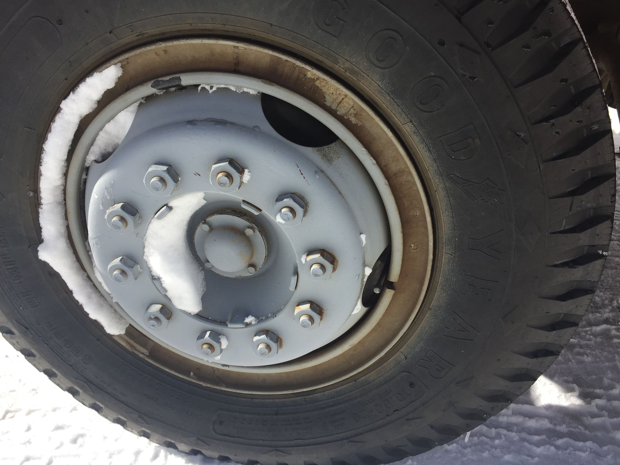

3/4 or 1 inch impact "needed" for those lugs. And a BIG air compressor.
What kind of wheels do you have?
Old May 10, 2021 | 09:41 PM
bhain's Avatar
bhain
Joined: Feb 2018
Posts: 80
From: Newport Wa
Wheels
Different wheel on the rears.

2501029 is the correct booster.
