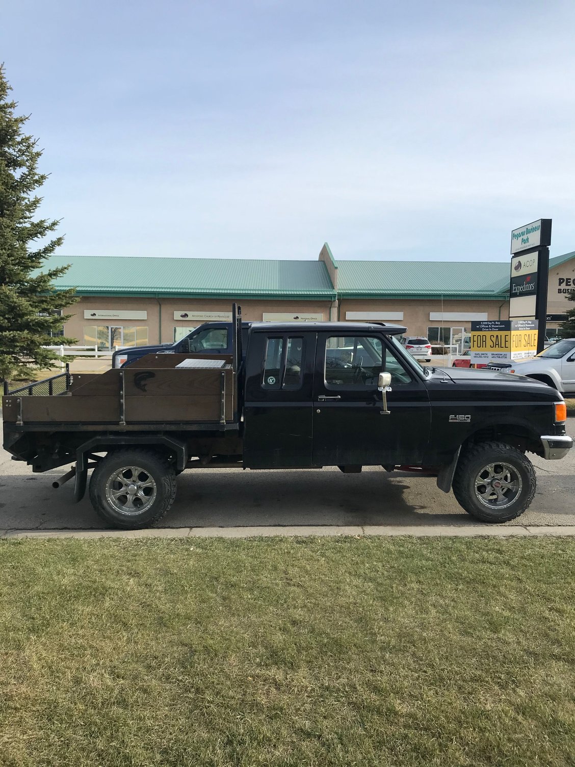

Old May 7, 2021 | 08:59 PM
Broncor's Avatar
Broncor
Joined: Feb 2018
Posts: 192
From: DEWINTON Alberta
Before...
After. Added a leaf, re arched existing and added a 3” block Rides real good
