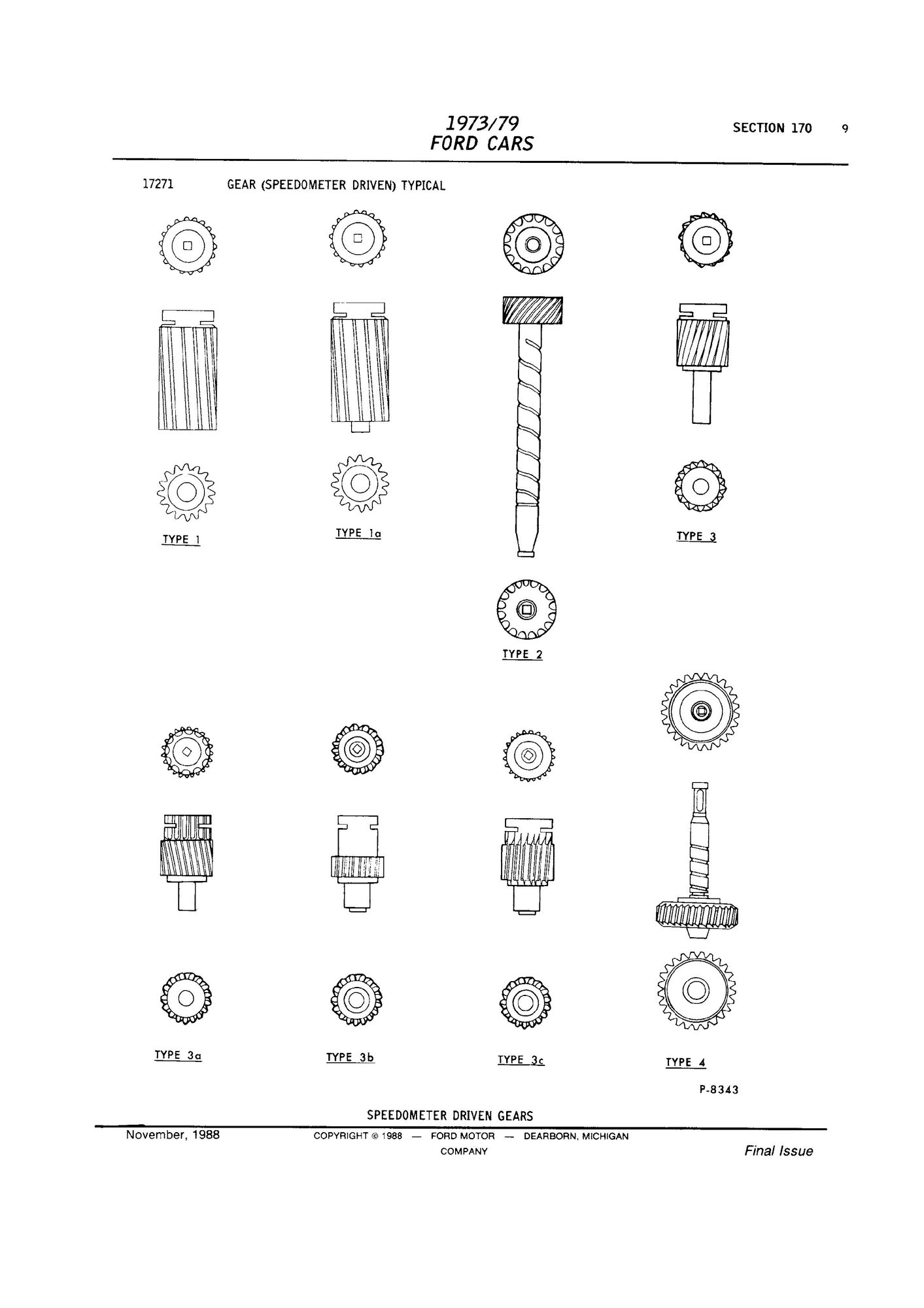

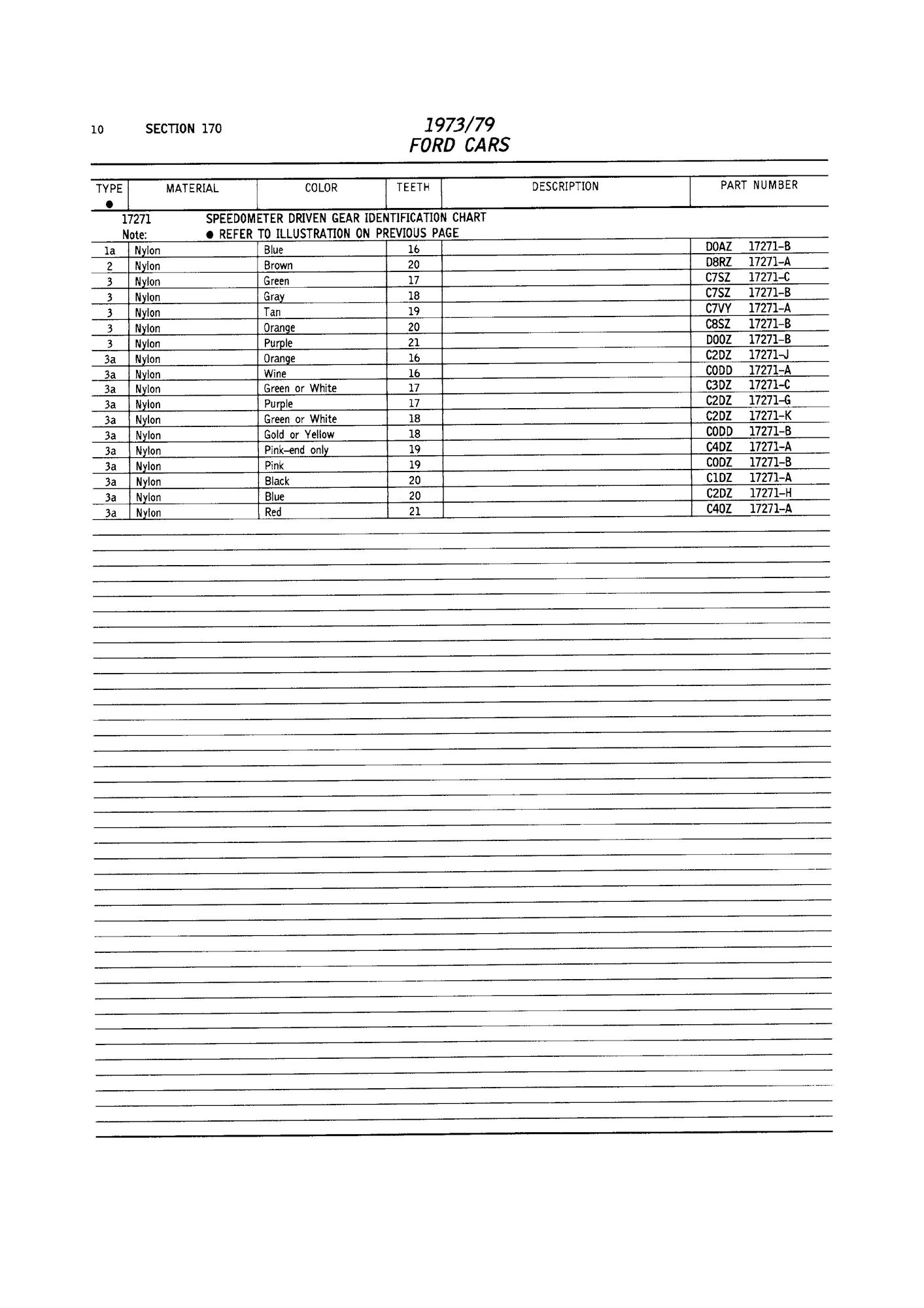

Well, took gear out of T-case, put cable onto speedometer, used drill - Baaam! Works fine! Put gear back into T-Case and now nothing works...again! I'm assuming there is a bad gear in the transfer case at this point.
It's ok, I have to replace the output seal anyhow!
Old Apr 23, 2021 | 11:31 AM
77&79F250's Avatar
77&79F250
Moderator & parts slinger
Posts: 50,279
Likes: 5,824
Old Apr 23, 2021 | 12:17 PM
MeanBigGreen's Avatar
MeanBigGreen
Joined: Apr 2021
Posts: 67
Likes: 11
From: Dayton, OH
Looks like it's a D3TZ-17285-A.
Found it on amazon for $16. Now, I have to figure out how to change it! LOL!
