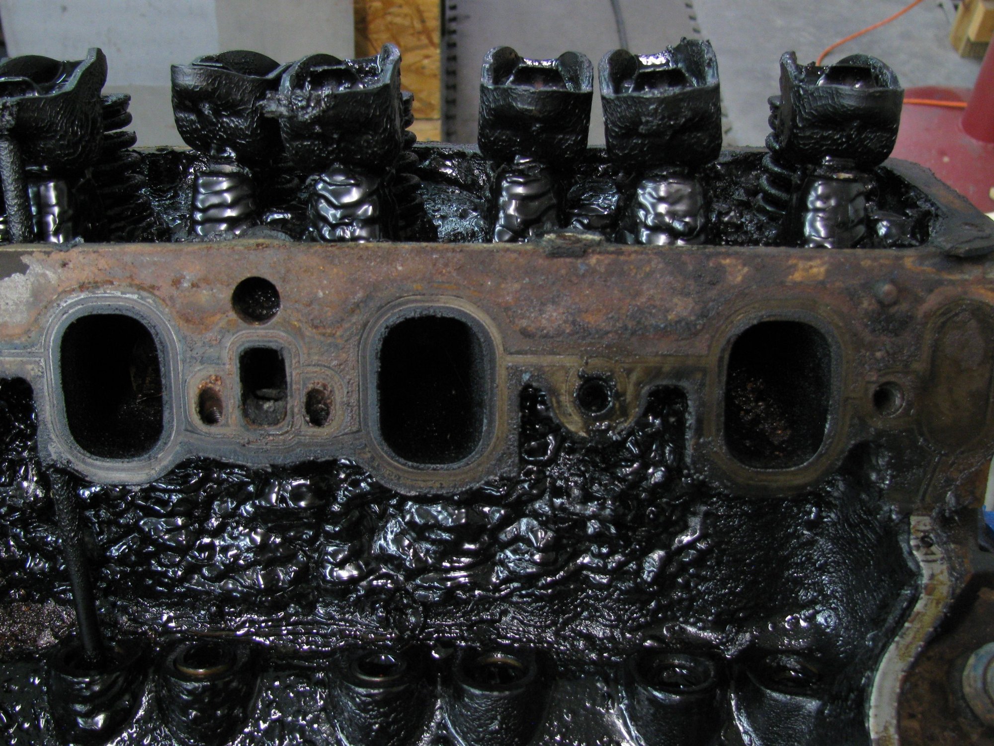

Since you started the don't change your oil. This is a 351 Cleveland I took apart last summer. I think they just added oil and STP every now and then. The machine shop soaked it for three days before they got all that off. Sorry about hijacking your thread alecs.
