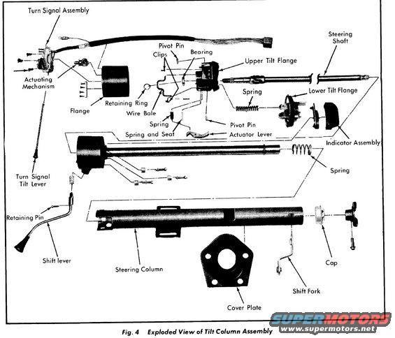

"First you need to remove the steering wheel, then the turn signal switch. Drive the roll pin out of the gear shift and pull it out. There is some spring pressure to work against to get the shifter out. Then, underneath the turn signal switch are two nuts. Try loosening these first then remove the casting. These are what "clamps" the collar in place. If you take the nuts all the way off the little square head bolts might fall into the steering column and can be a real pain to retrieve.
Once all that's out of the way, you can pull the shift collar off. To remove the turn signal switch, you need to remove the phillips head screws that hold the switch in place. Unplug the switch harness under the dash. Look at the harness plug, then look at the
terminals, there are little plastic fingers that lock them in place. Depress the fingers and pull the wires out of the plug. Be sure to make a chart of where the wires go.
Once the plug is removed, tie a string around the wires and pull the switch out all the way.
The string will make getting the wires back through easier. The shift collar just pulls off and the new one pushes on. After that reassemble in reverse order."
Thanks again for that parts diagram, I was able to verify I was ordering the right bearings (or at least what I think is right) ...saving me some time!
