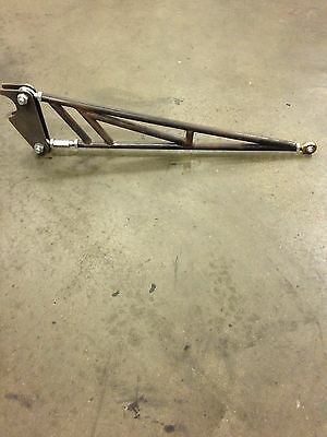

This one looks nice! Don’t buy one, build one, or find someone to build you one. You don’t really need all the fancy heim joints and adjustment. Just find some pipe and a bolt that fits tight put a grease zerk on it, you’re not worried about RPM😃 make it as long as you can, it needs a shackel on the frame side too. It might not fix your problem but I bet you’ll be happy you did it. It might help locate your problem.
edit: I’m pretty sure you don’t even need spring bushings if you’ve got one of these 👍
edit 2: that one is either upside down or for a drag car
