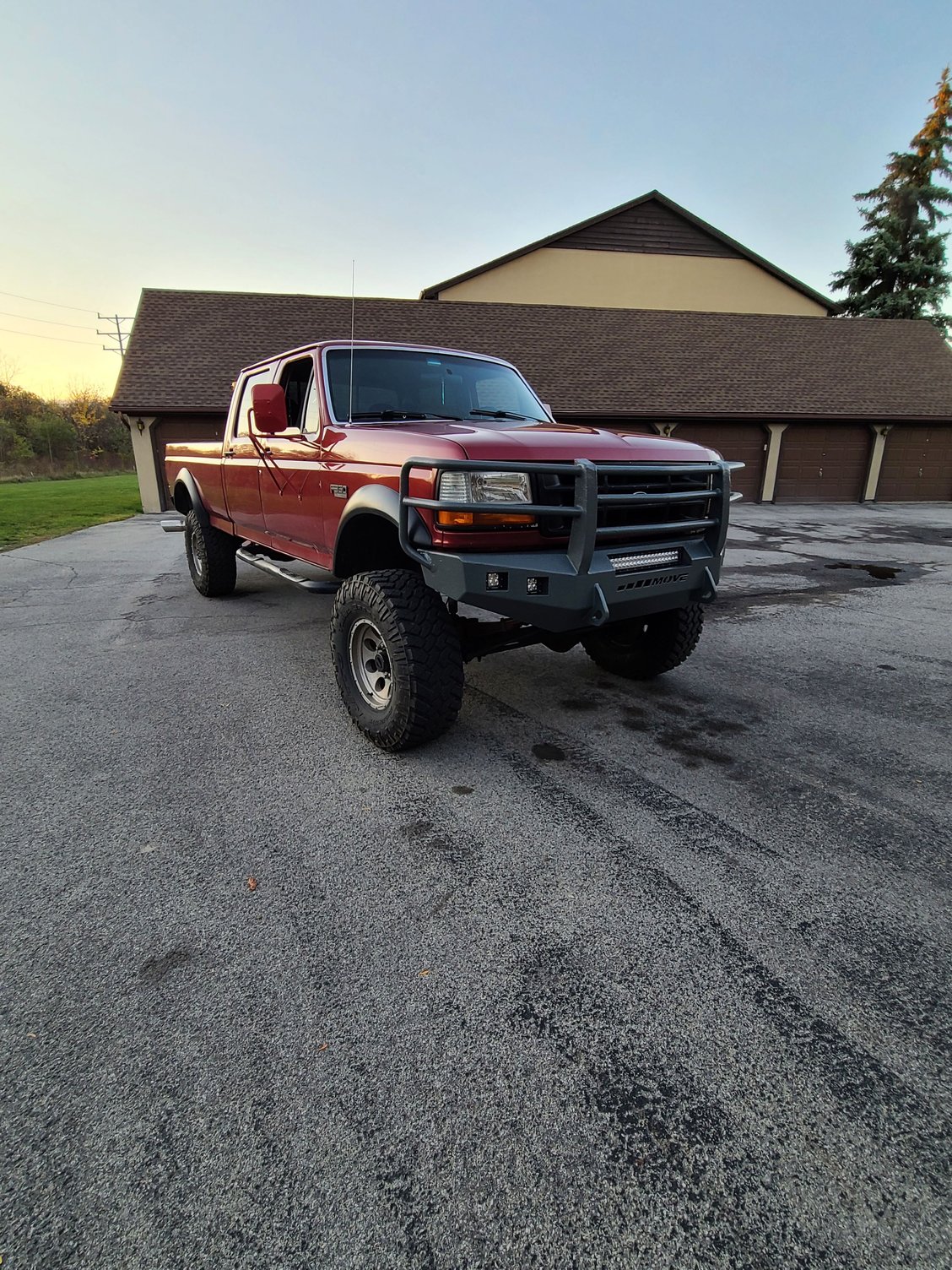

Ok, hi guys new to this forum, hope that I can get some help. I have a 97 f350 7.3 has an electronic fuel system and has a 4in exhaust besides that it pretty stock engine wise. My problem is I get a jolt when I press or let off the accelerator and seems to get more aggressive when I press and let off rapidly. It's like I'm hauling a trailer with a smaller trailer hitch ball. No engine light nothing and truck runs pretty good , hasn't thrown any engine codes, have replaced icp the map sensor, the ebps and tube, the ipr regulator, cps. There is a relatively new within the last 6 months rebuilt transmission and rearend im stumped any and all advice is welcome.
