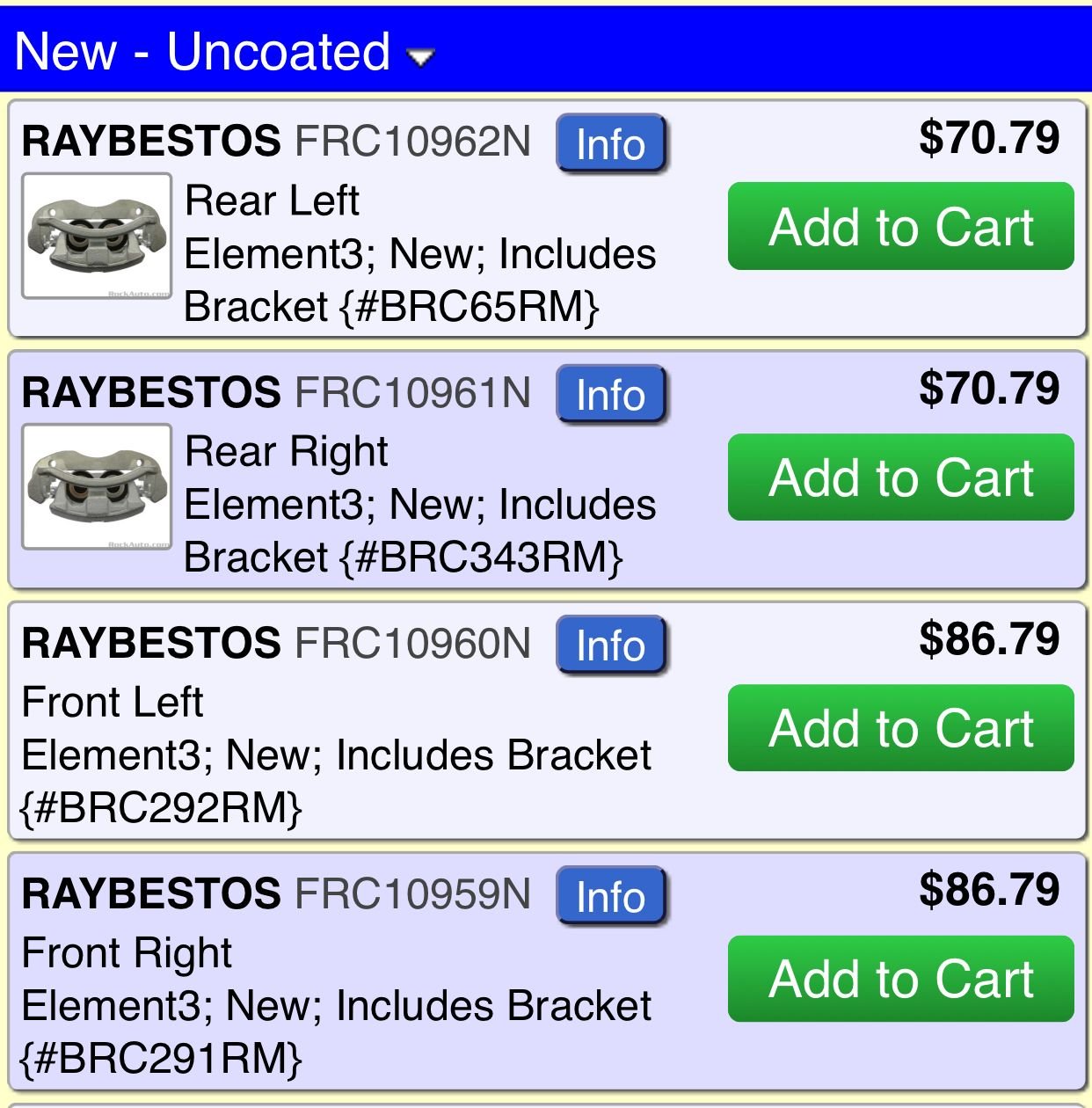

for our vehicles Raybestos is making brand new castings which means no more leaking piston seals due to pitted cores on remanufactured calipers.
