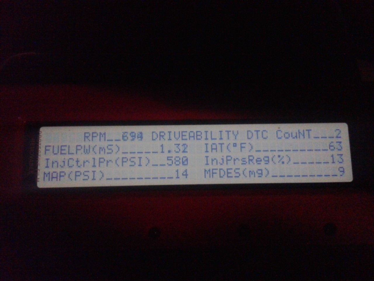

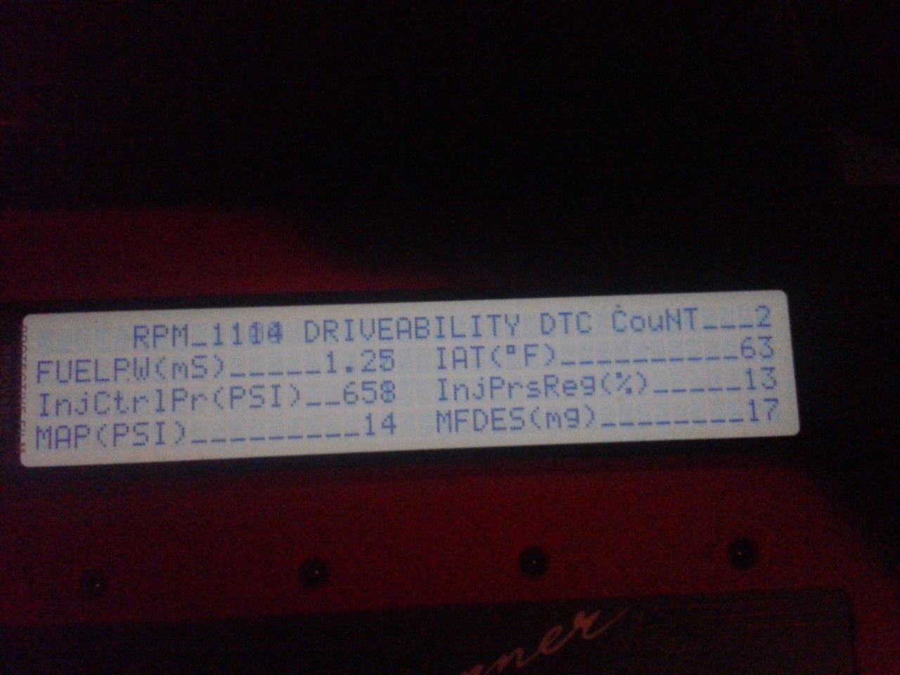

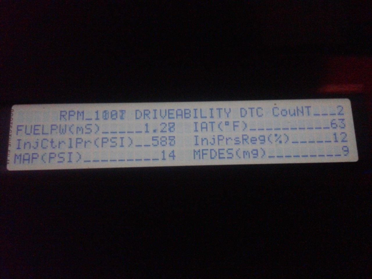

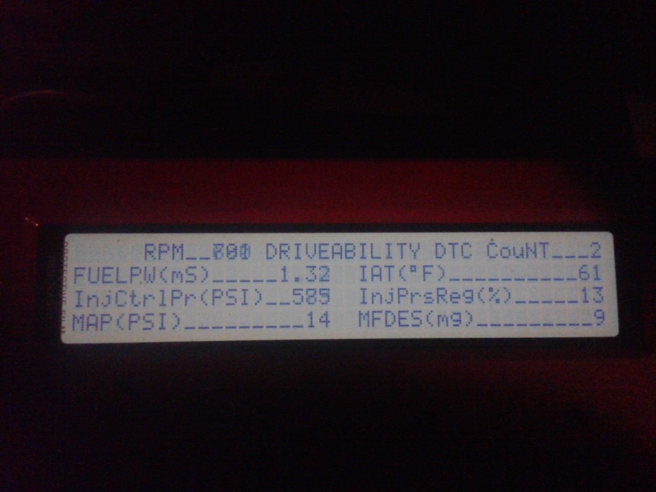

i do not hear it while sitting in the truck but when i turn the volume up on the video it did hear it. so i went out and pulled the belt ( after your post) and spun all the pulley's. the alt is original and was dry......sounded like rolling a bowling ball down a concrete drive way. as i am heading out on a trip to the dunes this week i went ahead and replaced that. upon testing the voltage at the battery before and after, i discovered i have two out of 3 volt meters that needed to be thrown away! one was showing 18.9 v's at the battery and the other 5volts. the 3rd one and the cheapest one shows what my snap on scanner shows 14.2volts at idle. that craftsman volt meter was a very nice volt meter, don't know what happened to it either.
so after a run into town to get 30 gals of e85 for my sand rail, i decided to pull out the snap on scanner and just view some data. this is an older snap on scanner and cannot be updated beyond 2005. i have the powerstroke key for it so does all i have needed to with the truck. the retired mechanic that was selling it knew it was no use to current mechanics. he took very good care of it and had several keys and cards for it. i gave $100 for it and keep it in the truck, won't be horribly upset if it was damaged but i do like it. i snapped a few pics of the data stream while at operating temp ( 185* according to the autometer gauge) , at idle and iat was reading 59*. brian at jelibuilt stated to me ( per a phone call) that he targets 620 icp and that i should be 10% ipr. this was all per a call asking for a revision for my " custom tunes" for my e99 as the idle quality can get poor at times. it's not all the time though and does change with tune but does not go away. i was speaking with brad about sacrificing one of my spare valve cover harness's and a solder on pig tale to make a sort of break out box to test the inj's.any suggestions as to what switch's to use for such a test? just want to shut each inj down to monitor mfdes. i will do this but not until i get back from the trip. i will also data log through ae or down load another program. so one interesting thing was that oil temps were 5* cooler at idle compared to the autometer gauge. brad was telling me that every time he has experienced a poor idle he had noticed his pw was below 1.5 depending. i was not experiencing the poor idle/lopey idle while looking at the data. wasn't a great idle but wasn't the poor idle i have been chasing.
php heavy tow mode
php daily driver tune
php stock tune
php high idle
jelibuilt stock tune
jelibuilt high idle
jelibuilt daily driver
jelibuilt heavy tow
again these are all at operating temp, at idle. just thought it was interesting to see the changes per individual tune per tuner.

You may need to crop and reload those pics or something, don't know I'm not very useful in the tech department. Trying to view them on my Android phone at least they are to small and can't zoom in.

i just noticed that. supposed to direct link it to postimage and expand but that i not working. if i select open link in new tab they go full sized. let me try this another way.
jelibuilt heavy tow
jelibuilt high idle
jelibuilt stock
php daily driver
php high idle
php stock tune
php heavy tow

The 2 things that jump up and slap me in the face are the IPR DC% on the high side for hot idle, and the significant difference between jellybuilt and PHP for your mass fuel desired. I know when mine sounds the worst at idle my MASFD is high. 9 and below sound ok get in the 10,12,15 range and I start loosing my mind.
Old Apr 25, 2021 | 11:23 AM
dsrace's Avatar
dsrace
Joined: Apr 2021
Posts: 424
Likes: 97
when i swapped all the parts , 205/30 inj's, t4 up pipes, bgsxe366 and adrenaline hpop, i bought a motor craft ipr. i bought it off ebay, said motocraft and showed up in a motocraft box. i have had no issues that i know of but i suppose that is possible. i just find it funny that every tune commands diff perimeters at operating temp idle. it even effects idle rpm as you can see in the pics. again, i know that's not a data log and i will work on that. it was a little unsettling to have brian from jelibuilt simply tell me it's pointless to write revisions, i need live tuning and there's something wrong with my motor. he said that based on my statement of i think ipr is at 14%. i was simply asking him if he could make a revision to turn pw up a tad but i will run some tests to verify a few things before i look for another avenue. i have the dcp21 pcm but really don't want to swap out the e99. i do pre fer jelibuilts tunes as the tps isn't overly sensitive as all the others. his tunes are the best on tip in for towing, now just need a little better idle. apparently now most don't want to write tunes for e99 truck now. i would be more than happy with a live tune if i could find someone close to home as in 4 surrounding states lol i will have to see if there is anyone in ft worth/dallas area before my next trip down there, that is after i check a few other things.
