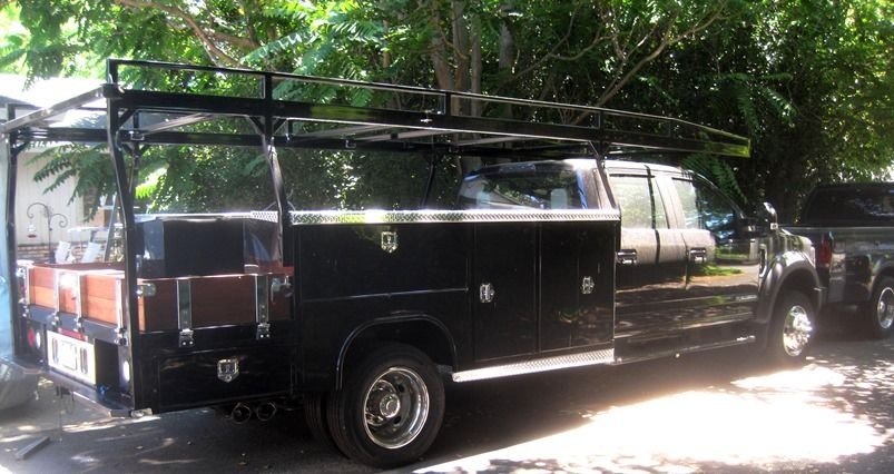

I mounted the Hopkins Endurance (distinguished by the hexagonal shape of the lid) on one truck, and after that, vowed I never would again.
The plastic that the Hopkins Endurance feels cheap and chinsey. The lid spring is noticeably thinner in wire diameter, compared to, say the Pollak brand. And the foam gasket seal isn't as robust.
Having said all that, the Hopkins Endurance is probably the best made plastic one that is available at retail stores, without special ordering.
Hence, I special order trailer connection sockets when setting up a truck..
I've liked and used the Pollak brand since 1979. Pictured below is a truck I set up 40 years later, still using Pollak (although Pollak as a company has changed hands several times over the years, including changing hands last year, in the the time since I ordered the connectors for the truck pictured below).
Pollak has a metal RV 7 way flat blade, but the black nylon reinforced version that I chose, as illustrated below, has a better sealing lid with a deeper pawl to help retain the trailer side connector better, as well as more support underneath the trailer plug.
This particular truck tows equipment trailers with hook and lunnette eye pintle hitches, as the same trailers are also tag towed by Class 8 bobtails now and again, hence the need for the 9 way round pin, which has a far more robust trailer connection in every way imaginable. So most trailers that are owned have this connection... but the problem is... most rental trailers are set up with either 4 way or 7 way flat blade RV. If a piece of equipment is rented, it often isn't planned, nor is the rental yard typically local, so being prepared for all possible trailer wiring configurations has saved the day (literally), and as such, a spring loaded drop down door behind the license plate hides a few more quick adapters, all of which mate to the 7 way RV Flat, which by far is the most commonly found nowadays on light trucks.
If, despite changing ownership hands once again, the Pollak brand has maintained the quality that made them the go to brand of decades gone by, then I'd recommend looking at what Pollak has to offer to meet your requirements, which I assume are commercial, not recreational, based on my memory of your unique cab chassis truck with the outboard cylindrical fuel tank.
All trailer sockets are RECESSED into stainless pockets, which has eliminated trailer socket lid breakage from boots kicking the lids off when climbing in and out of the back of the truck.

That is a work of art, thank you for sharing. What type of truck is that attached to?

Originally Posted by Sous
Not everyone can say they have a bed rail made of cedar (or whatever that wood is).
The wood species for those swing down stake gates is Keruing, more commonly known as Apitong.
It is a hardwood, much of which is found in the Philippines and other Southeast Asian islands, with characteristics quite similar to that of Ipe from Brazil.
Cedar is too soft of a wood for truck duty, and wouldn't last a month.
