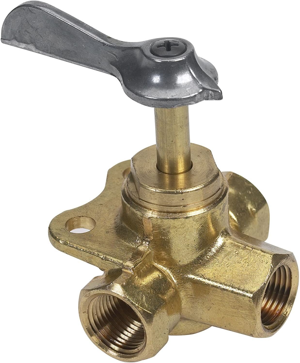

here's a selector valve that can run AN fittings here's a selector valve that can run AN fittings
The Sky's the limit. Just get your wallet ready.
