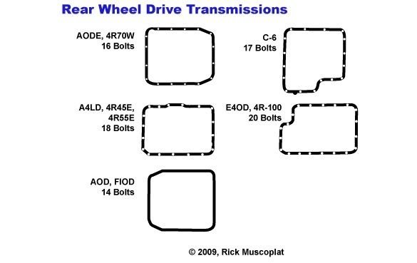

3. How can I identify what auto transmission I have?

3) Check the sticker on the door pillar, it will have the Trans Code.

3) Trans code on the door jamb sticker, or compare the bolt pattern of the trans pan to pictures on the internet.

Wouldn’t the only auto transmissions in ‘87 be a C6 or AOD?

The door tag describes the transmission as "T." Mostly from info on the internet, it seems this year would be a C6. I do not know if it has overdrive. I just need a way to confirm that is what it is.

What is on the gear indicator? Does drive have a circle around it or not? Is it D or (D). I’m fairly certain that trans code T is the AOD or Automatic OverDrive.

Trans code T is AOD. Since this is a flat tappet motor you will need a cam and lifter set if doing the cam, but those only come in at around $200 most of the time. That should not require pushrods or anything else and no the computer doesnt need to be reflashed, and that is a good thing because it can't be.
