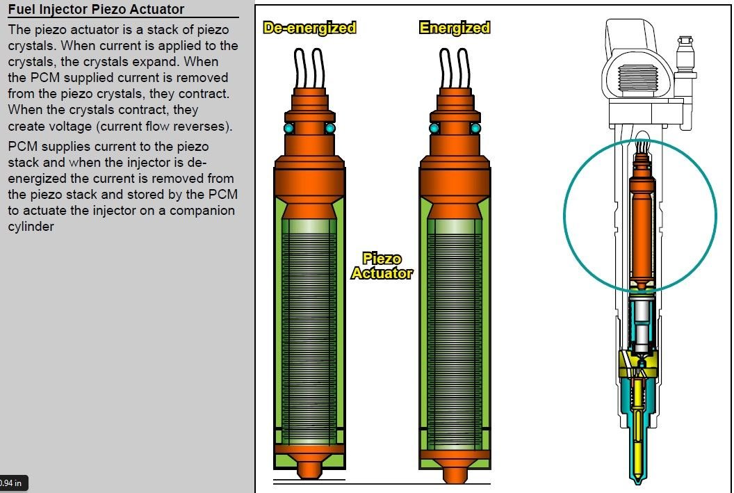

The numbers on the injectors is called "IQA". They get this "number" when they are built and tested at the factory that builds them for Ford. The IQA has to do with the flow rating and contribution balance to the 8 cylinders.
When you say the injectors are leaking, is that fuel into the cylinders or fuel onto the valve cover/intake manifold? The injectors are not hydraulic/oil actuated/operated. The injectors are electrical (piezo electric).
Is this mechanic knowledgeable of the 6.7 fuel injection system? There have been very few threads on the 6.7 injectors on FTE. None that I remember about them leaking.

Originally Posted by guidowitz
The passenger bank of injectors are leaking on to the valve cover and manifold
Sounds more like you have the high pressure fuel line leaking than an injector. Look at these photos. The high pressure fuel lines can be replaced or tightened.
