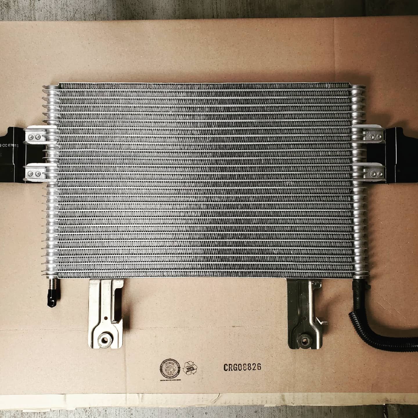

Bringing back this thread to give an update - got the 26 row cooler from the 6.0 installed in the v10 yesterday. As expected all the mounting holes lined up. I did have to get some longer M6 bolts for the two lower mounts to accommodate the rubber bushings. The most challenging part of the job is getting creative with routing the hoses and avoiding kinks. The original hoses route out the top of the cooler, the 6.0 cooler routes the hoses out the bottom.

Old cooler pulled out. Seeing the v10 14-row cooler in person, I cant believe the one in the 7.3 was even smaller.
Ford part number for the cooler

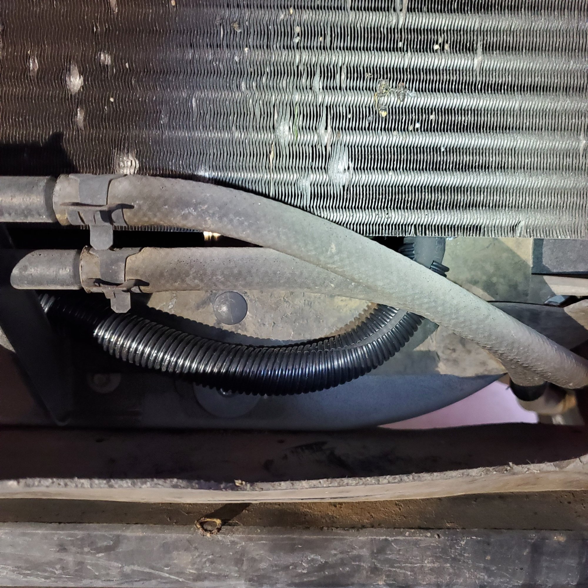

This is how I ended up routing the hose that exits on the left (driver side) of the cooler.
This is the hose that exits on the right. The cooler i bought from the dealer came with a short section of molded hose and I just let the hose take the path it wanted to based on how it was molded. Its not following the same path the hoses used to follow with the old cooler, but it isnt kinked and I secured it with zip ties to keep it from flopping around.
