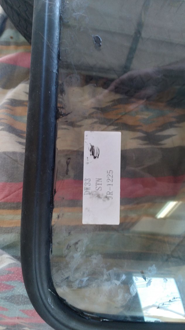

avf100's Avatar
avf100
Joined: Oct 2010
Posts: 2,091
Likes: 599
From: Lancaster, CA.
Originally Posted by avf100
Thanks all for your replies......I'm thinking of using the butyl on the frame only since it is more uneven with the spot welds.
Changed my mind ....I am going to use the butyl in the glass side & the frame side. It definitely is messy but it cleans up easily. I put the rubber on the glass yesterday & my wife & I are going to install them in the truck today.
This was the messiest part of the windshield.
