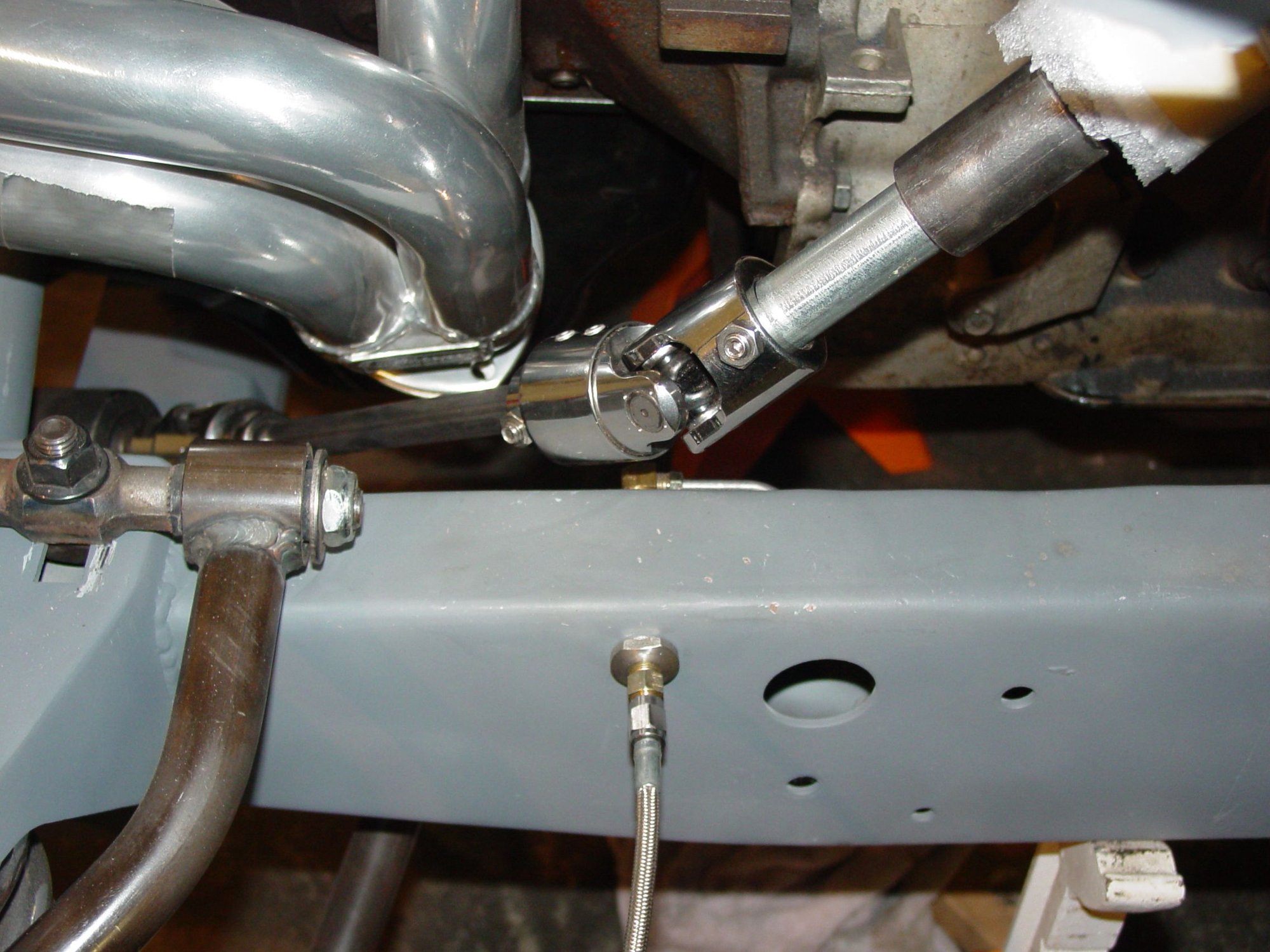

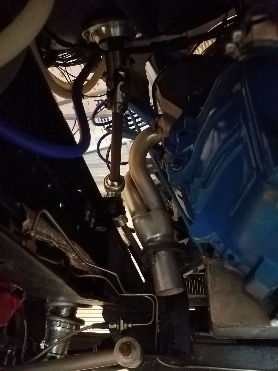

Here is what I had to do on my F1 body sitting on my F4 frame.
Top view
Top view going down to rack. There is a little more clearance than it looks like. See the next underside view.
Bottom looking up

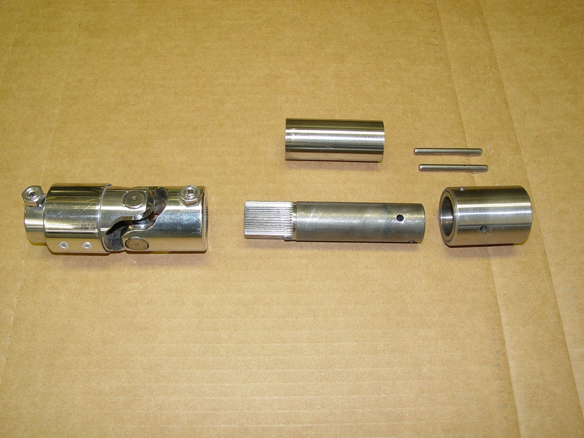

headers and linkage are always giving us guys trouble.. I extended my steering column shaft 6" or so to get around the Sandersons. this is in a '53 with a 460
https://jniolon.classicpickup.com/co...columnin_a.htm

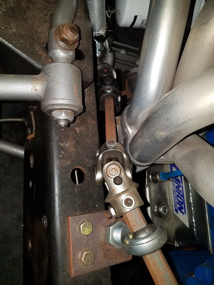

I used two joints to make clearance around my Sanderson headers. Chevy 350 and Jag IFS.
