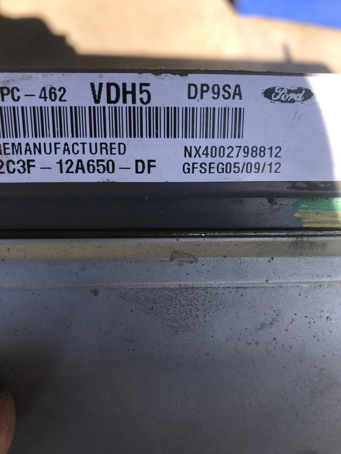

I do see on my pcm is is refurbished, PO must have done that
