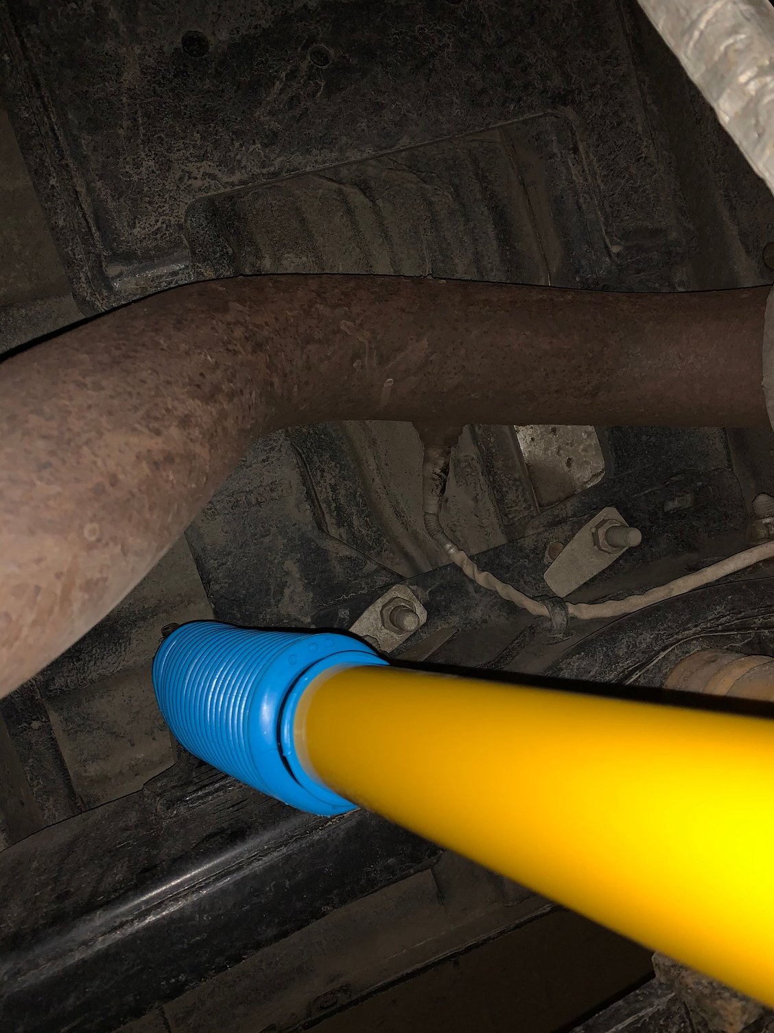

Hi everyone; I just installed a set of 4600’s on the rear of the truck. Fronts will go on tomorrow.

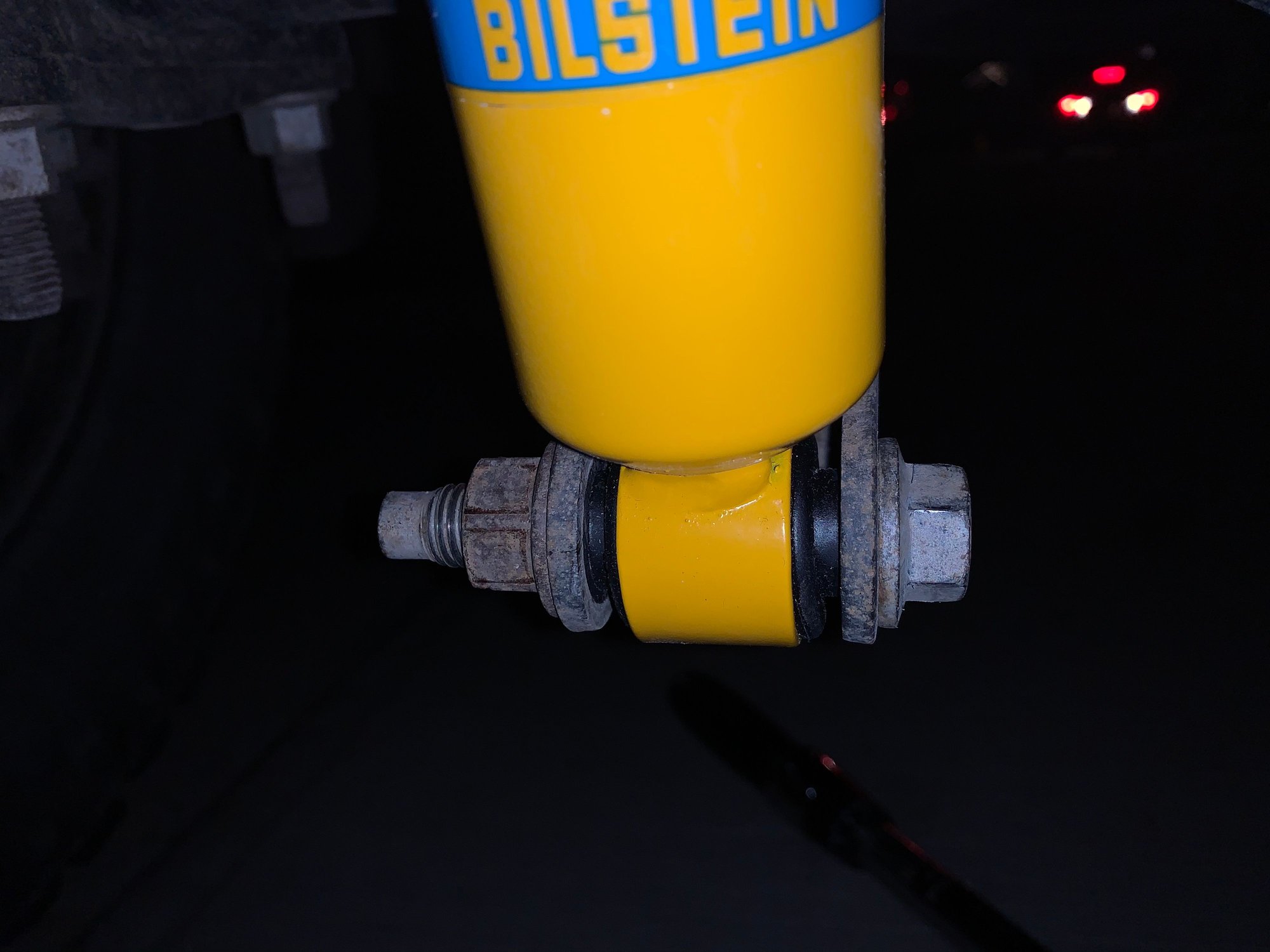

for the rears the way they come set up the booot is at the top of the shock, and to me is fairly close to the exhaust. I just wanted to see if anyone has had any issues with this. And the bottom eyelet has a small metal sleeve through it, it’s fairly thin and has a little rubber around it. I tightened everything up to the correct torque specs. I just wanted to see if I should put some washers in?

Did the stock shocks have boots? If so then you are OK. The photo appears to show about 2.5 in, clearance to the exhaust pipe which seems a little close. If there is 4 in. clearance I would not worry. As for washers I would not install and I don't think you could get them in there I have 5100 on my Tundra and I had the same thought but there is no room.

You are good on both. Give us a review after driving with those new shocks for a few days. Thanks

I put 4600s on last week, no issues. Truck’s been through regen also, boots are fine.

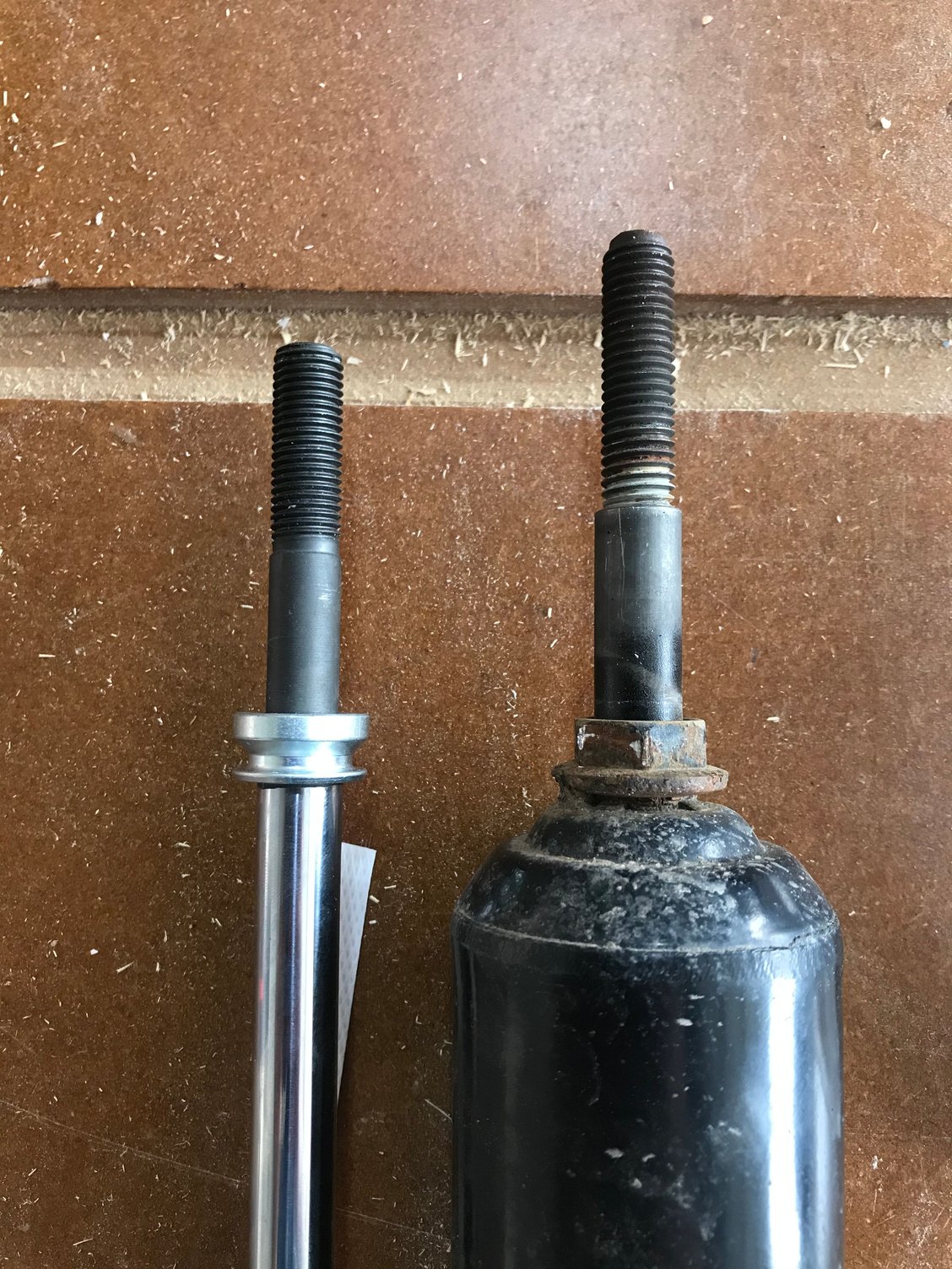

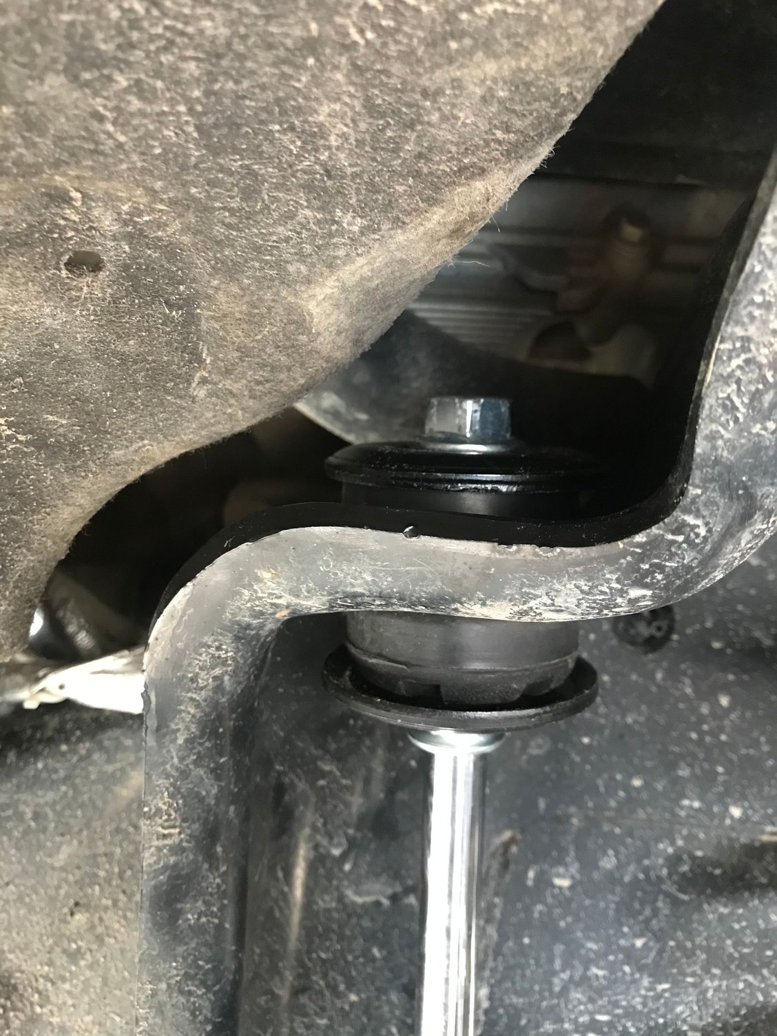

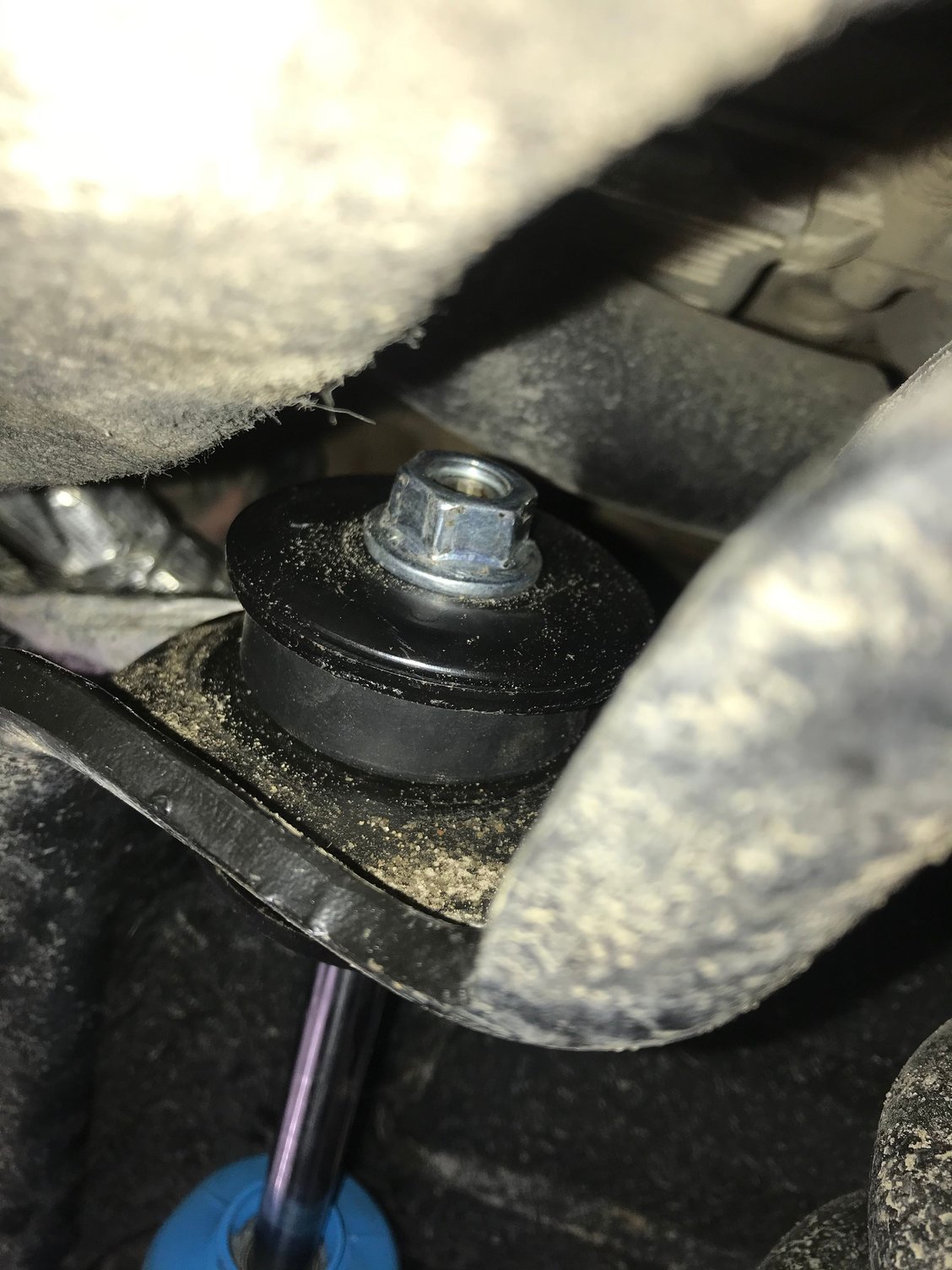

now! Onto my next problem haha
The top shaft that goes through the upper mount, it has no way of holding the shaft from spinning. The nut is on but doesn’t seem to be as tight as it should be. Checking the bilstein instructions and multiple YouTube installs for different shocks, it should go through more than what it is. I attached some more pictures see what everyone has to say.
im a carpenter so! My experience on all things mechanical is a bit limited. Thanks everyone 😁

Originally Posted by alliz1986
Scrap that last one...
duhhh 😑
glad you figured it out. It’s a little bit of a pain to tighten unless you have those ratcheting box wrenches (which I don’t), but the Allen key works.
