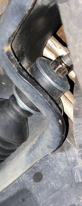

  #28
4wd6.7L's Avatar
4wd6.7L
Joined: Dec 2020
Posts: 8,640
Likes: 2,435
Originally Posted by MDK993
My buddy did that part ofpare install. I do plan on double checking them this week though.
If he's replaced shocks before then I'm sure he got them right.
I was looking at a friend of mines Ram the other day, it has a Bilstein lift. I noticed his upper shock nut was flush to the top of the stem and the bushing didn't look to be compressed. He had a guy help him do the install that must have stopped when the shaft started turning and thought it was good to go. He's been driving like that for at least a year and said he hasn't noticed anything wrong 🤷🏻‍♂️. He usually has so much crap floating around in and out of the truck that I'm not surprised he never heard or felt that the shocks weren't tight.
Old Mar 28, 2021 | 11:19 PM
  #29
MDK993's Avatar
MDK993
Joined: Jun 2020
Posts: 336
i went and took a quick look and the nut isnt even flush. Ive got at least 5k miles and havent felt anything loose but Im not 100% confident after a visual inspection. Ill get a wrench on them this week.
Old Mar 29, 2021 | 12:32 AM
  #30
4wd6.7L's Avatar
4wd6.7L
Joined: Dec 2020
Posts: 8,640
Likes: 2,435
There is a torque spec, something fairly low like 25 lb ft., not exactly sure on that. It should look something like this (not my picture)
