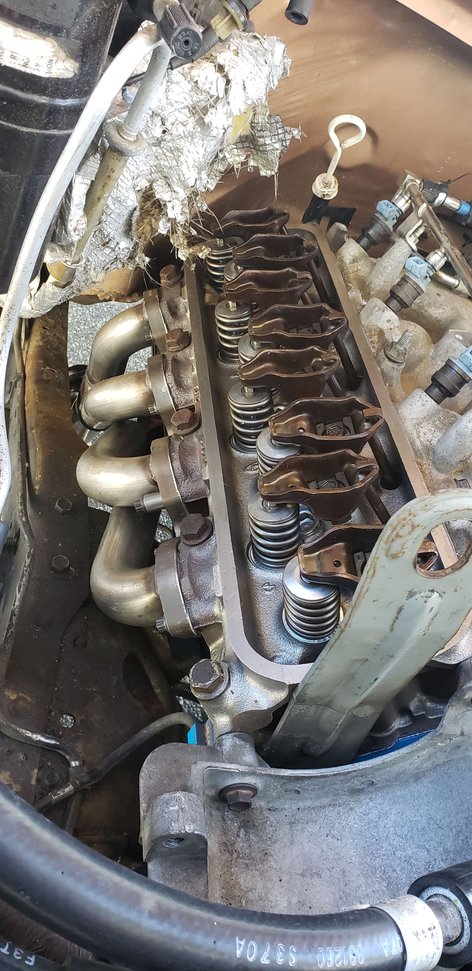

Here is the original cylinder head, you can see the broken studs:
I had the heads rebuild, and broken studs removed. Then went on to rebuild the entire engine. Here is a shot on the stand, with the headers loosely attached:

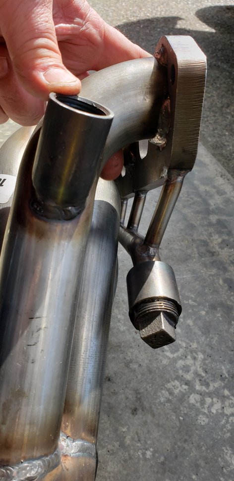

By using the Banks headers, I did not have to deal with removing and plugging the connections on the exhaust manifolds. But, here is a shot of the drivers side manifold, and the fitting you would need to remove, and block off, passenger side is similar:
Since the Banks headers do have fittings for the AIR system, I needed to block them off. On the passenger side, I made a plate:
On the drivers side header, there are 2 bungs. 1 for the AIR injections system, one for the EGR tube. You can see in the picture, I used a plug to block of where the AIR injection system would attach. Where my thumb is, is where the EGR tube attaches:
