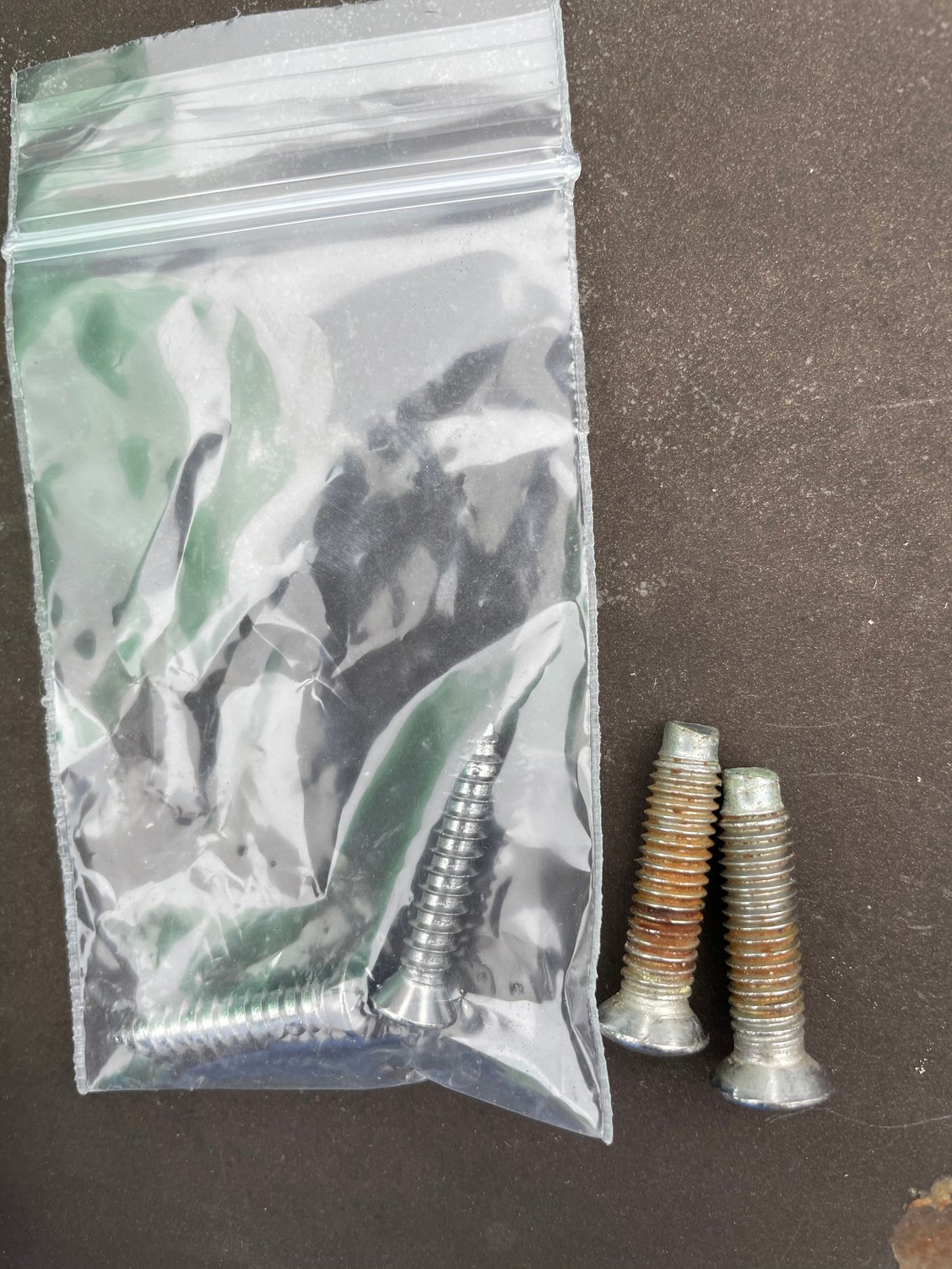

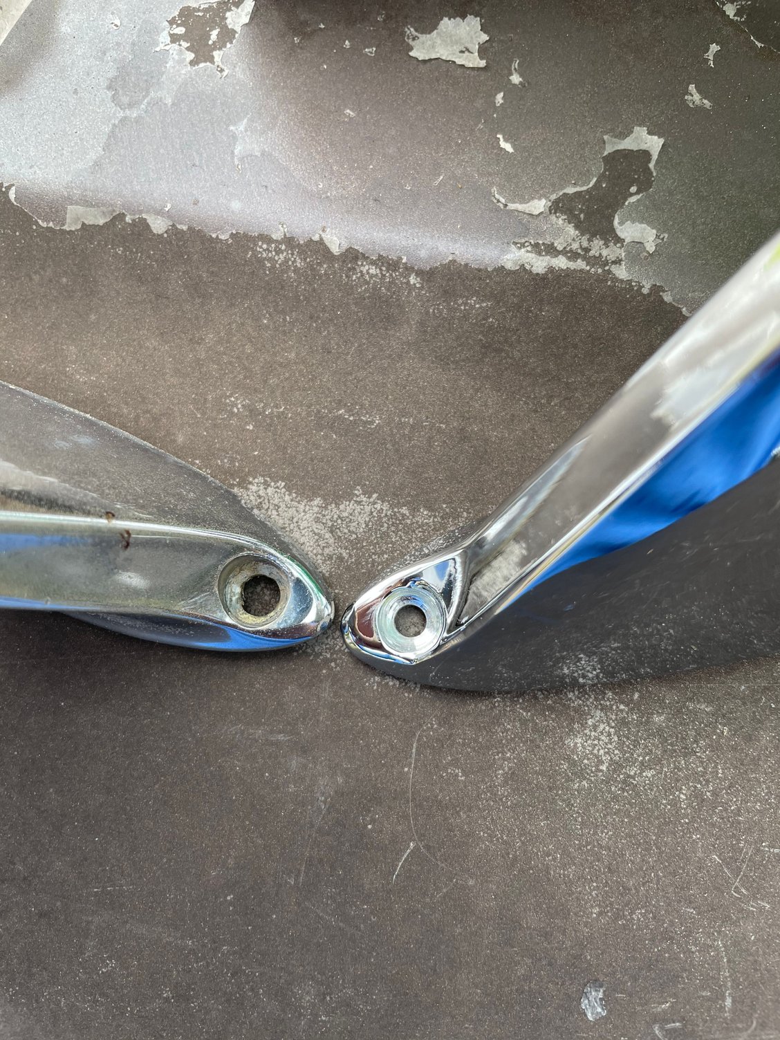

The chrome on my old mirrors is looking pretty dingy these days so I decided to replace them with some new ones from BG. I really don’t want to be the guy who is always complaining, but again, these were not a direct fit without modification. They came with small phillips screws to hold them to the door. My truck has M6x1.0 torx head screws. I had to use a 1/4” drill bit to enlarge the holes in the new mirrors. No big deal. After that they fit fine. They are a little floppy though. The passenger side moves in the wind at normal road speed. They look good though!
