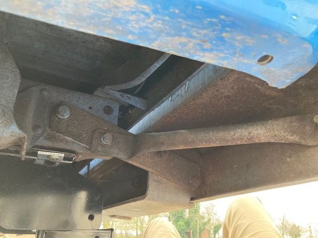

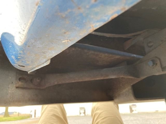

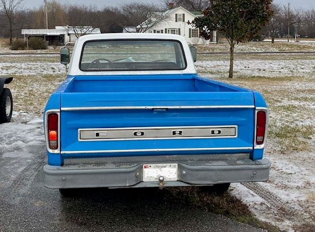

I want to replace the current rear bumper on my 73 F100, see the attached picture. I have also included photos of the bumper brackets that are currently installed. I want to install an original style chrome bumper that matches the front. From the information I have seen the brackets I currently have may not work on an original style bumper. Any thoughts or comments on the situation are appreciated.

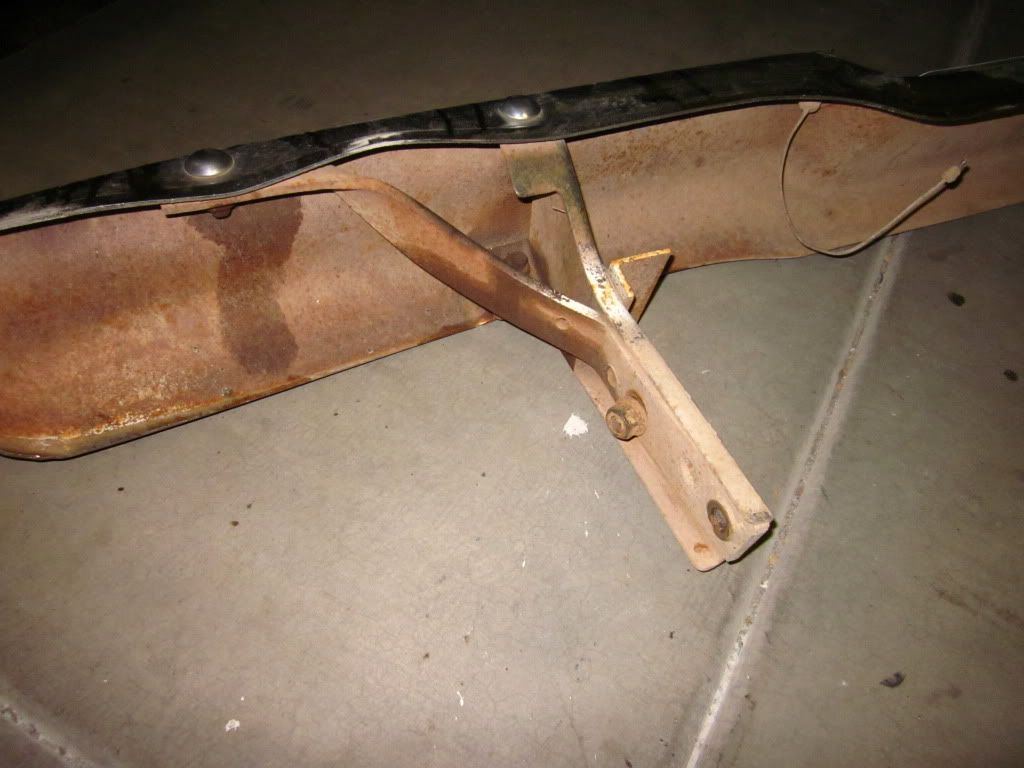

Is this the style bumper? This from a 78.

the bumper you have now is an original bumper. it sounds like you want to go to the sport bumper and your brackets will not work on it.

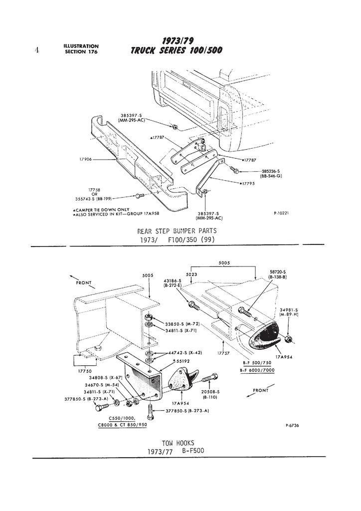

Yes you now have a step style rear bumper and the brackets will NOT work to put a sport/contour rear bumper on your truck. Without some heavy modification. AND the sport/contour rear bumper brackets are almost impossible to find. The thread below talks about it with pics.
https://www.ford-trucks.com/forums/1...e-you-can.html
What you need, but not all there. https://www.ebay.com/itm/1973-1979-F...44u000azm00004
All there https://redirect.viglink.com/?format...oAAOSw9iZgMQH-
What you are looking for. You need to locate the outer support bracket also. They are quite thick and have some weird twist angles to support the outer edge of the contour bumper. You can source the contour bumper brackets off a 78/79 bronco also. Of course with the contour bumper.

Yep that’s the one.
