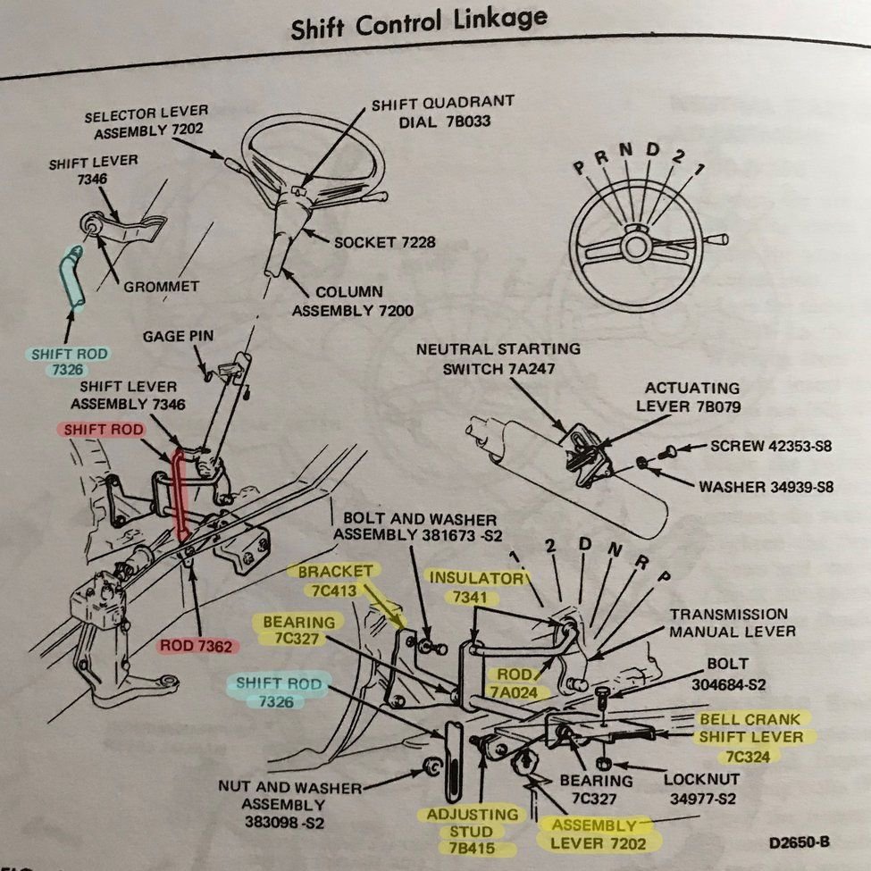

Does anyone know what I can do to fix my shifting linkage? I have a 78 f150 auto that shifts backward and skips a gear every time I shift it. I recently purchased it, the dude I bought it from had a pipe clamped to the lever to shift it and I'm trying to correct it.

Well with that cut and welded sign on the one lever, you definitely have some mod work there. With modified shift rods no telling what is causing the issue. I would try to get the actual linkage and get it set back up correctly.

So based on those diagrams you posted, I need to look for part "7A024", right? Where would I find that part, because I've looked online, CL, FB Marketplace, and a ton of salvage yards for that one piece and I can't seem to find it anywhere.

Yes #7A024 looks to be cut/welded modded. But like you said in your visitor message to me, you need to confirm you have a truck C-6. Comparing the Transmission Manual Lever (part # 7A256 in the diagrams), yours tooks to be oriented differently. Yours is facing down versu facing up?

And also, for the part "7A256" you said was flipped upsidedown, how do I turn that back around? Should I try and turn it 180* and if so how do I do it? How does that come loose?

Comparing the way the 7A256 is in the diagrams and looking at your, yours looks to be installed wrong. But that could be a truck trans versus a car trans set up. And that is why you have the cut welded lever? I do not know how to take it off. I'd have to look at it and do more research, if I was going to do it. If you grab the lever and move it does it at least go thru the 1,2,D,N,R,P range? Be careful under there, make sure to chalk the wheels, truck could roll when you pull it out of park. Trans guru chime in time.
